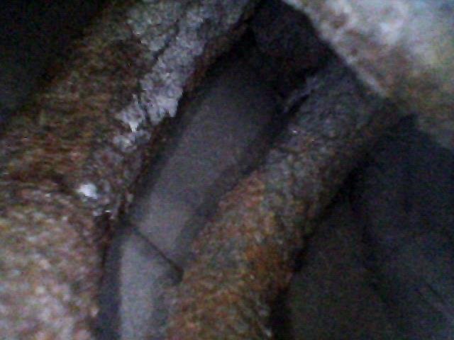

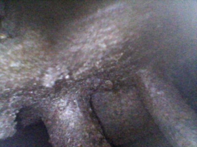

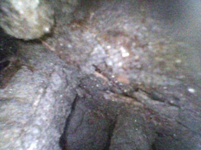

Ok, so I've done a bit of narrowing down the past few days but still looking for suggestions or thoughts.
I checked both banjo bolts / screen filters on the injection pump and they were clean as a whistle. Decided to isolate the fuel injector pump and injectors to test them independent of the tanks / fuel filter. I ran straight Seafoam motor treatment directly into the injection pump and cycled it back through the tank return line to my supply bottle containing the Seafoam. Ran for about an hour total - no gunk, debris, discoloration was visible and the motor ran perfectly. No hunting, stumbling, hard starts - nothing unusual. In fact the tach stayed pinned steady to where I had it set to idle, van turned over first turn of the key every time. So I think it's safe to say that my issue is back of the IP / injectors.
swapped out the old fuel filter for a new one, just to be safe. the old one was 1 year old but looked totally fine. I run seafoam treatment from time to time, occasionally add lucas injector cleaner and habitually run Shell 'V-Power' diesel with higher cetane. Seems to be keeping everything clean so far, makes for easier starts in winter and generally better performance.
I moved on from the fuel filter to the fuel tanks/lines to have a look and diagnose. Drained both tanks and got an inspection camera inside the rear tank to check the condition of my pickup screen. It's spotless, no buildup whatsoever. checked the condition of my fuel lines. They're not new but they don't leak. I'm considering swapping them out if my issue persists. As of now the van is hard starting - unpredictably (sometimes turns over first kick, sometimes a few seconds of cranking, sometimes takes 3 tries to get it to turn over - even if the engine is warm or has just finished running and I start up again just to test). Also stumbles while idling (when drawing fuel from the tanks) and will often idle so low that it dies at stop lights or when I decelerate - especially if I've just accelerated and then backed off. None of this happens when the tanks are full to the top with fuel, symptoms start around 3/4 full and get progressively worse as fuel levels drop from driving. Drives fine, just has trouble starting / decelerating / idling when fuel goes below 3/4.
I got the inspection camera up around the back/top of the rear fuel tank and noticed quite a bit of corrosion on the metal lines coming out of the top of the tank - from what I understand these are the return lines from the injector pump and the line that feeds to the fuel filter housing mounted in the engine bay. I feel like whatever I do I'm going to have to deal with the corrosion I see either now or later, it's eating away quite a bit of material.
Am I missing something obvious here? Is there any way to test for air leaks? Should I just go ahead and swap out these fuel lines? I had removed those lines and refit them just prior to this stumbling/hard starting issue beginning and I'm starting to think they need replacing. Would worn our fuel lines make sense given what I'm describing?
Looking at the corrosion on these tanks I feel like they're going to need replacement / refurb sooner than later. Would that corrosion on the lines feeding my fuel lines be the culprit? letting air in? I guess I can put clear lines on there and just watch what happens, but also open to other suggestions/ideas/experiences. The tanks don't leak, all the filters are clean and everything runs fine ahead of the fuel filter. really want to nail this down and get back to having confidence on longer hauls.
