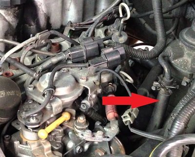

The first thing that comes to my mind is an air leak in a fuel line. GBNZ suggested to me to temporarily replace the fuel hose from the fuel filter to the Injection pump with a clear tube and watch for bubbles. I believe I used 3/8" ID, about a foot long. It's an easy hose to swap. Attach it to the fuel filter housing first, prime it full using the pump on the top of the fuel filter housing before tightening the end on the Injection pump.
This one:
IP line.jpg (40.82 KiB) Viewed 32365 times
Bubbles (while the engine is running) would indicate air being drawn into the fuel line somewhere between the tank and the Injection pump. It may be just a loose clamp on that actual fuel hose (or a pin hole in it...)
Don't leave the clear hose in as it will eventually melt from the heat of the engine... :shock:
