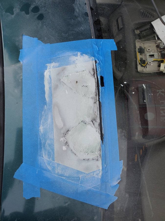

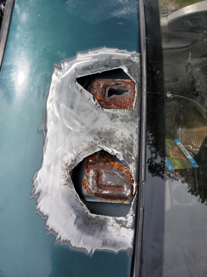

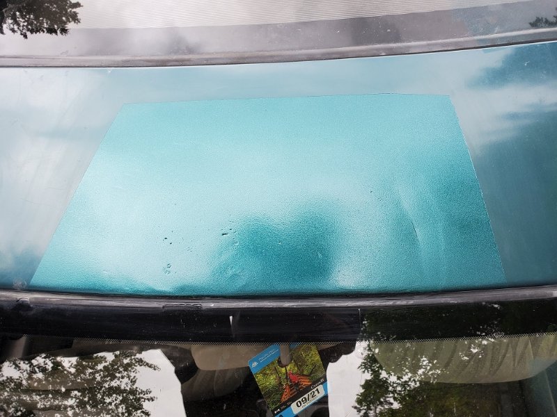

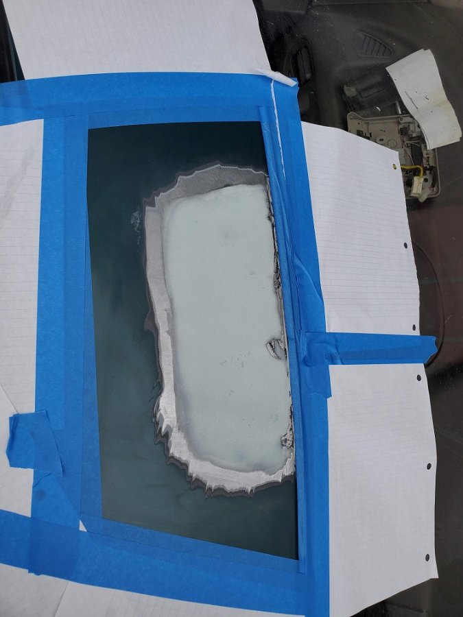

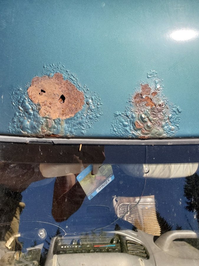

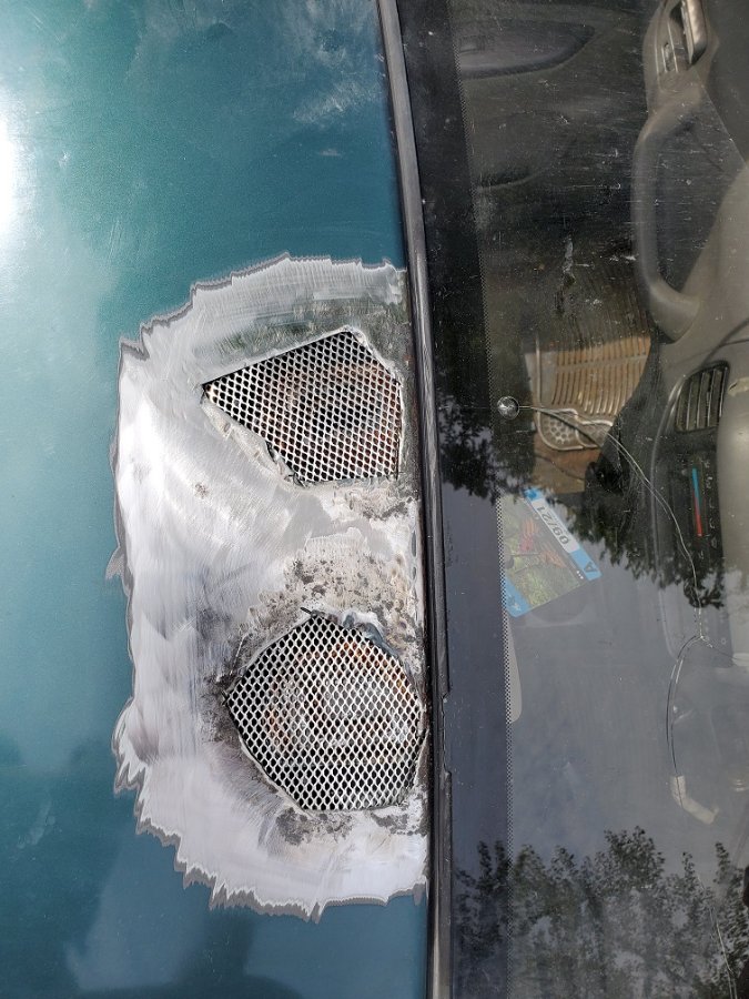

Maybe this will be useful for anyone with a similar problem or is hesitant to do body work. This was my first time doing rust/body repairs. It was straightforward, its a very forgiving process. Its not perfect, but itll stop the rust, so good enough for the girls I go with!
