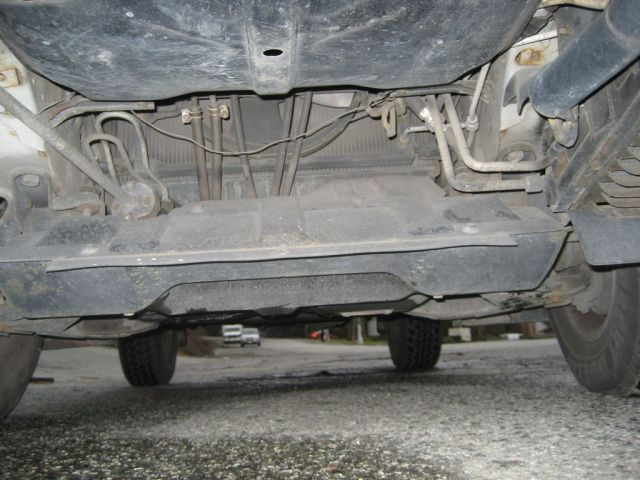

We finally got our Delica on Monday and are loving it. I took it out to do some dashing through the snow near Kamloops last night, and the front underside got pretty filled up with snow... It seems like there should be a front skidplate here, am I just missing it or do these not originally come with one? It's a 1990 Exceed, and here's what the front underside looks like:
(Does anyone know where I can get one?)

Re: Is something missing here?
I don't think there are any factory shields here as this is the air intake for the rad. This is one of the weaknesses of the delica design. It's possible to scoop up all manner of stuff. I think someone mentioned fabricating some kind of expanded metal screen or some such for this vulnerable area. But I could be wrong....
It looks like you don't have a skid-plate... nor do you have the bracket to mount the skid-plate. Just wondering if the 'Exceed' doesn't come standard with it or if it is an all-model accessory.
I too have seen the expanded-metal screen put in place, just to cut down on the amount of stuff that could get kicked-up into the radiator.
With the exposed bottom of the rad and those hoses I figured it's only a matter of time until a branch jams itself in there and punctures something...

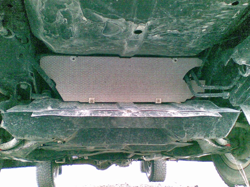

This is what I have done, I got the idea (and the metal) from a friend who did the same to his manual. Oh, I also used his tools, and his shop. Thanks Andy. :)
- Image003.jpg (224.27 KiB) Viewed 7211 times

pretty cool there, looks like it would work

Have you tried it in the snow yet? Wonder if the snow would pack against the mesh and block the ventilation instead of finding it's way around?

I don't think he'd be any worse off even if the snow does pack up against it, that whole area was full on me- and anyways- I'm sure a bunch of snow there will keep the rad cool... but no injuries to the rad, I like it!
I've ran it through snow up to the top of the wheels, it ended up pushing like a snowplow, and yes the grate collected it quite well, but jwfchase is right, at least it didn't pack against the rad. Then again the whole front end was packed with snow including all the steps and other orifices below 2 feet.delicat wrote:Have you tried it in the snow yet? Wonder if the snow would pack against the mesh and block the ventilation instead of finding it's way around?
I think the true test will be when summer rolls around here in Penticton, I'm thinking that it might stop too much air during the +40* weather. If it does, I will cut a Mitsu symbol to help with airflow. But when it comes to stopping sticks, bushes, grass, and birds, it works grate. (sorry had to throw that in there)
