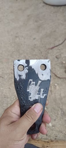

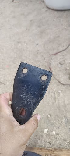

Here is the piece but the two captiave nuts are sheared off...

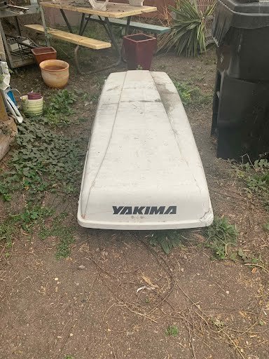

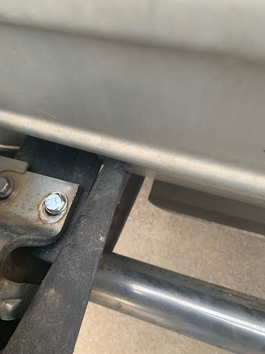

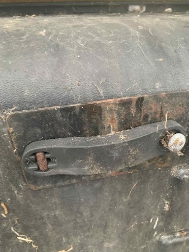

So this was the actual bracket from the Yakima roof box.
Cut edge; put in new holes... and put nuts on other side of bracket to simulate captive nut design on original.
Not pretty per se, seems highly functional.
For the next person: Mounted with I believe M10, 1.25 thread pitch (25 mm) bolts
