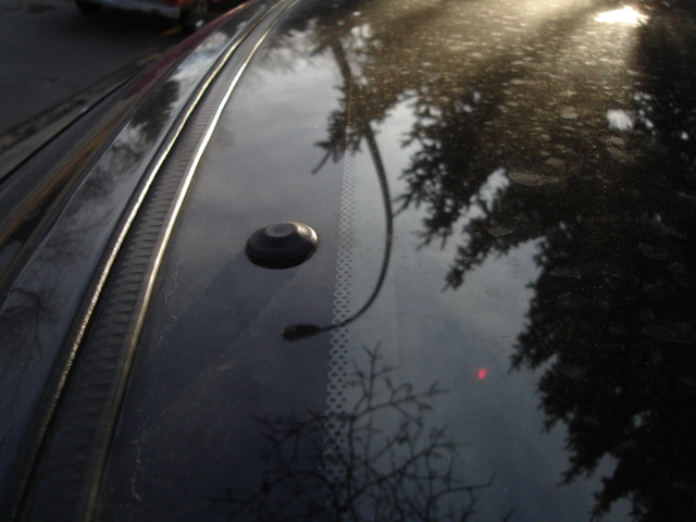

If you don't have the bolt part, then any nut/bolt combination would work. If you want to reuse the bolt, then you have to find a nut that fits, a washer, probably some rubber too. Not sure what Green1 used, maybe he'll tell us and/or post photo.
Best case would be to find a part number and order it. It doesn't have a part number on it. It looks like a rubber-covered acorn nut.
Here's what it looks like (surrounded by a reflected streetlight):
Studying the 2nd photo in my original post, I notice there is a rubber-looking gasket or washer between the metal hinge and the glass. Hope you still have that. If memory serves, it is more-or-less attached to the glass. There's also a metal washer under the glass that I think was actually part of the bolt.

I was scraping the windows last night and I noticed that the parts that hold the side windows in place look exactly the same as the nut on the sunroof. So dealers parting out Delicas might have these nuts.
