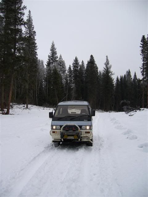

Thought I would post a few pics of my van at work. Playing around the deactivated crossig (did not cross) :shock: and playing in the snow on the snowmobile tracks :D :D .

This is the kind of weather the L300 is made for :D , too bad it's +10°C over here :cry:

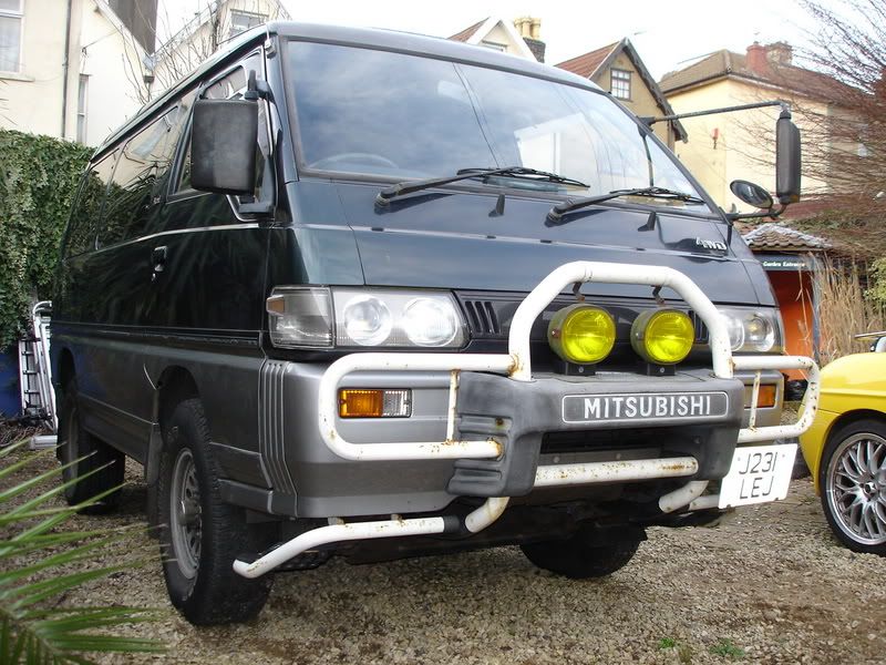

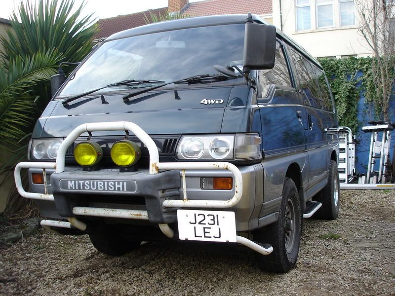

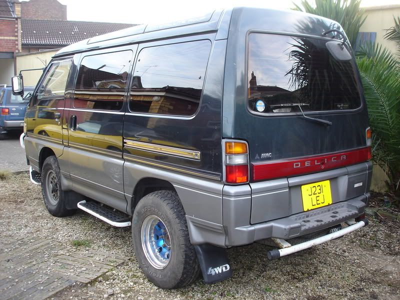

Here are some better pics of the Mud Monkey before I start ripping it apart! :shock: :twisted:
Doesn't look TOO bad! (rusty bull bars are coming off anyway! :wink: )

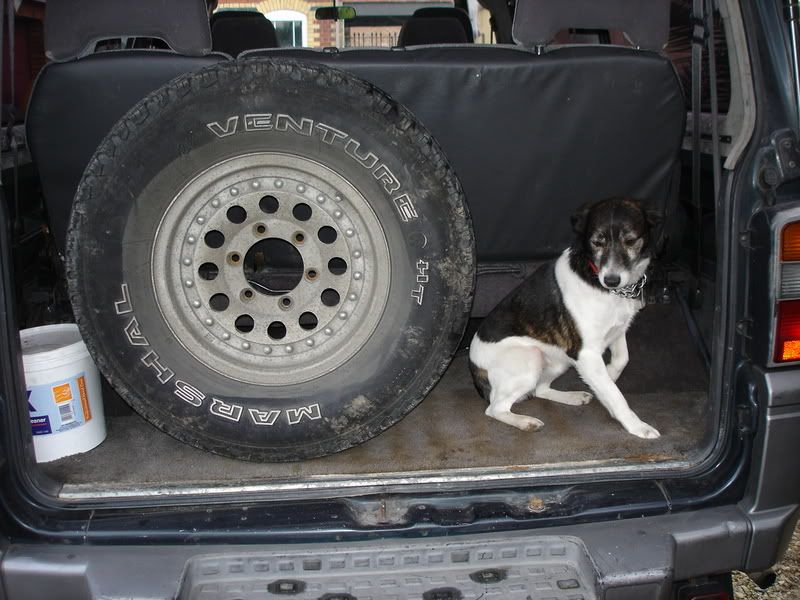

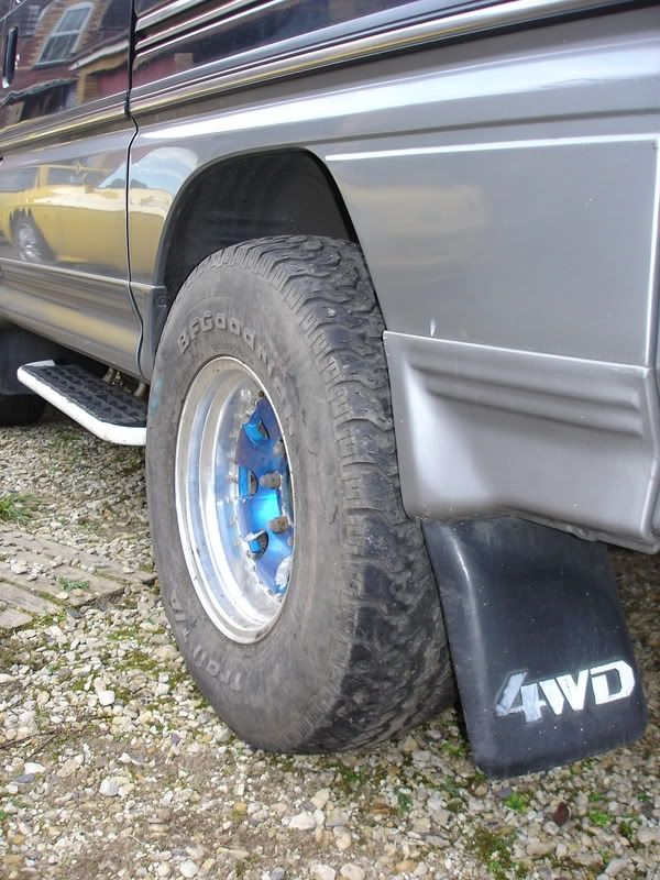

Wheels are pretty good - just need a clean....but TOO SMALL for my liking! :twisted:
This shot gives some idea of the wheel/tyre combo I'm after...(you have to try these things out!)
My theory (tried and tested! 8) ) is if the sliding door can function properly, the wheels/tyres can be made to fit on the other three corners. (sliding door binding is harder to fix than the clearance on the front arches! :? ) This wheel is one of a few 'spare sets' I have sat in my garage! :D :D
These are 8" wide split rims (going to be given a re-furb eventually! 8) ) and the sliding door is going to need some re-fabrication, re-engineering and some creativity on the slider brackets in order to make it clear these bad boys! :shock:

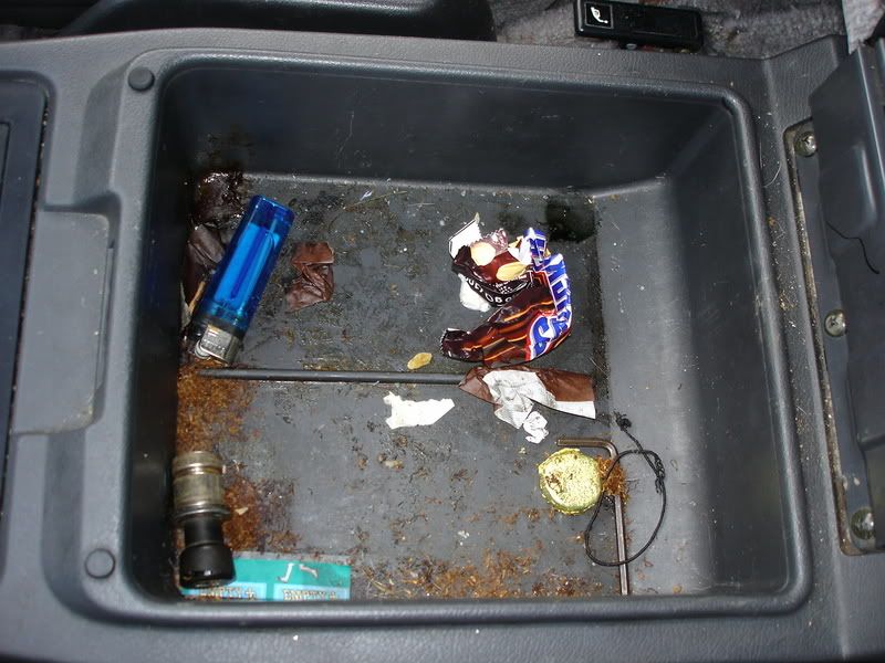

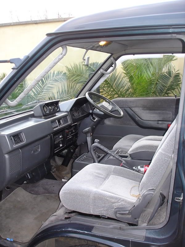

The interior looks OK in these shots, but it's pretty grubby.....fairly tatty and it STINKS!!!
Looks OK - even MORE stinky in the back!! Lots of ground in grime...but I don't care because 99.9% of the interior is coming out in the rear! :twisted:
Jed just couldn't resist getting in at least one of the photos! (and he's usually SO shy! :lol: )
This gives some idea of the sort of state the motor is in close-up! The photos make it look better than it really is, but this one kinda sums it all up really! Neglected and unloved! :( Soon to be given some true care and attention and before long it's gonna be a serious bit of kit! :twisted: :twisted:

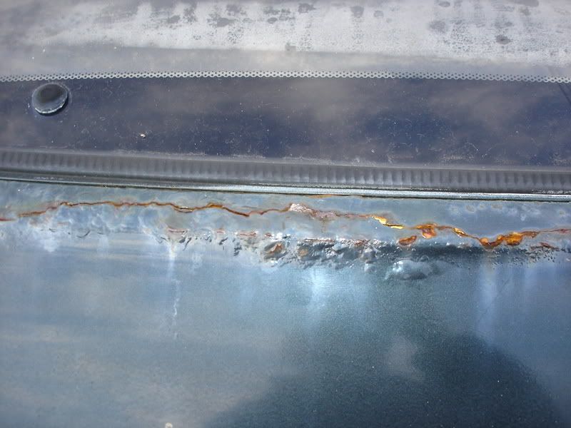

This is the only really bad part on the body! A long line of rot along the front edge of the sunroof! Is this a sign of a weakpoint in high roof Deli's, or just a one off?? :? We are gonna rip the sunroof out anyway, so we'll just cut the rot out too and panel it over and seal it up good & proper...

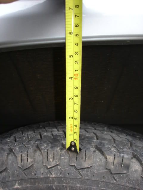

This was the clearance of the rear wheel BEFORE the interior was removed (5.5"):

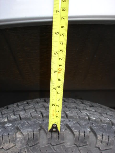

And this is the result of an empty rear cabin (6.5"):
That's right - a full 1" lift just from removing the interior!! :shock: :shock: (trust me - it weighed a LOT!! I've got back ache from lifting it all into the skip :roll: :evil: )

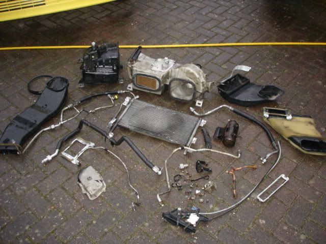

Next step - up on ramps and remove the complete A/C system!
This is 'most' of the system removed.......
......although there are still quite a few pipes to come out, as well as the compressor and the wiring loom.
The front A/C rad was binned a day or two ago (so no pics) and the electric fan for the main condenser has been 're-mounted' to take the role of fan for the coolant system in place of the nasty viscous fan.
This was not only a cheap (free) mod, but also a good way to ditch the viscous fan to reduce noise, increase power and possibly even gain some MPG!! 8) 8) 8)
