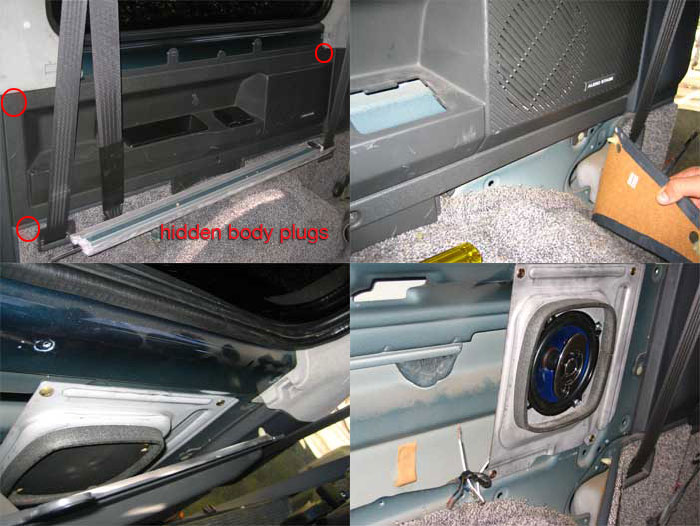

I don't think anyone has posted a play-by-play of installing new rear 5.25 inch speakers . . . so here it goes. This outlines the left panel removal and install, but the right side is exactly the same (except for a longer curtain rail)
  • 1 - Remove rear bench seat carefully (I scratched my window tint!)
    2 - Remove curtain rail with ~ 4 screws
    3 - Loosen bottom left rubber window seal
    4 - Loosen light grey panel pictured top-left of top-left photo (pop out grey plastic plugs)
    5 - Unscrew visible screws on plastic body panel and hidden screws behind carpet (pictured top-right photo)
    6 - Pop the plastic panel out from the body panel from the red circled areas (man, that plastic is BRITTLE!)
    7 - Once the panel is out you'll see the bracket holding the 7watt stock 5.25 inch speaker.
This bracket has welded nuts and the machine screws were completely stuck. We finally got the speaker out but we had to replace the machine screws when we put in the new 180w pioneer speakers.
We figured out that the blue striped wire on the right side went with the pioneer's black wire, and on the left side the grey striped wire went with the black striped wire. Of course I don't know what colour your wires are but hopefully this will help someone else. We were a little surprised to see different colours on each side. We just soldered the new short wires to the old---the old speaker's connection didn't fit the new ones.
They sound so much better--the difference in quality is amazing. I found a powered 200w 10" sub woofer in a slim box at Best Buy for $150, and it fits perfectly behind the drivers seat. That'll be the next project.

I'm just in the process of doing mine too. I have the rear speakers done now. I was super careful but still broke the front top tab on both left and right panels. Automotive goop and some tape to hold it while it dries and it'll be fine though. I didn't bother taking out the seat and it wasn't too bad, just had to move the seat forward and back while having it folded up.
For the machine screws in the speakers I used my impact driver (manual impact driver that is) to loosen them and it worked great without damaging the screws.
