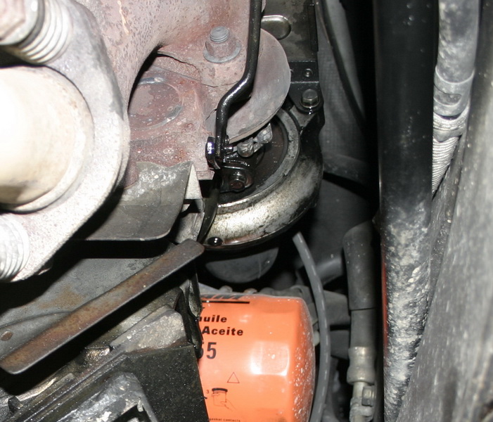

Here is my turbo leak. Documented
Don't panic; it does not reach the ground.

yup thats what mine is like although my engine is dirtier than yours :) I get the sad little drop of oil right there on the bottom of the turbo.
