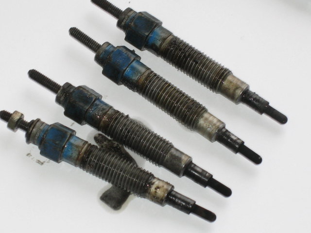

The old plugs. Note the small tips.
Original NGKs.JPG (51.19 KiB) Viewed 4278 times

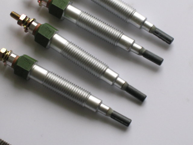

The new plugs. Note how large the tips are compared to the others.
New Mitsubishi Plugs.JPG (45.26 KiB) Viewed 4279 times

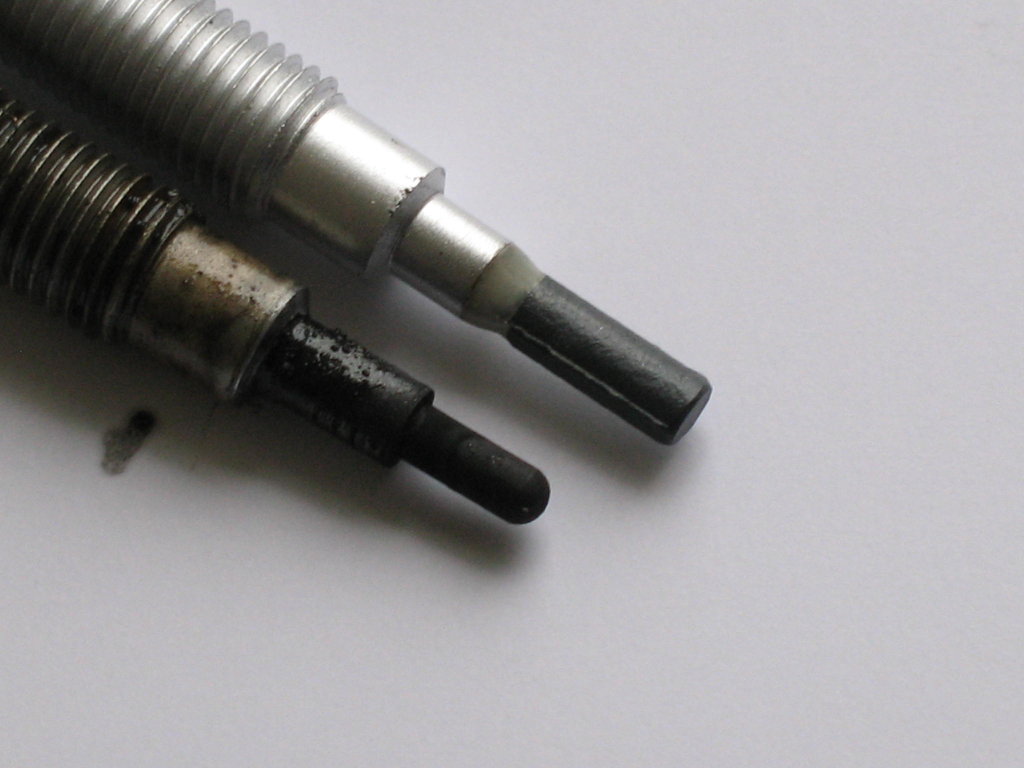

Here's a better comparison:
Comparison of elements.JPG (83.47 KiB) Viewed 4279 times

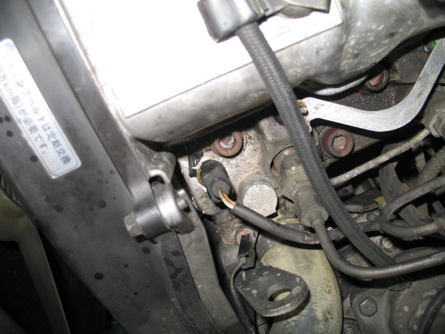

This is the temperature sensor which was faulty (the plug with two wires in the upper left of the image)
Temperature sensor.JPG (68.72 KiB) Viewed 4279 times
The other temperature sensor (with the single wire at the bottom left of the image) is the one which is used to set the gauge on the dash board--two sensors reading temperature for two different purposes.

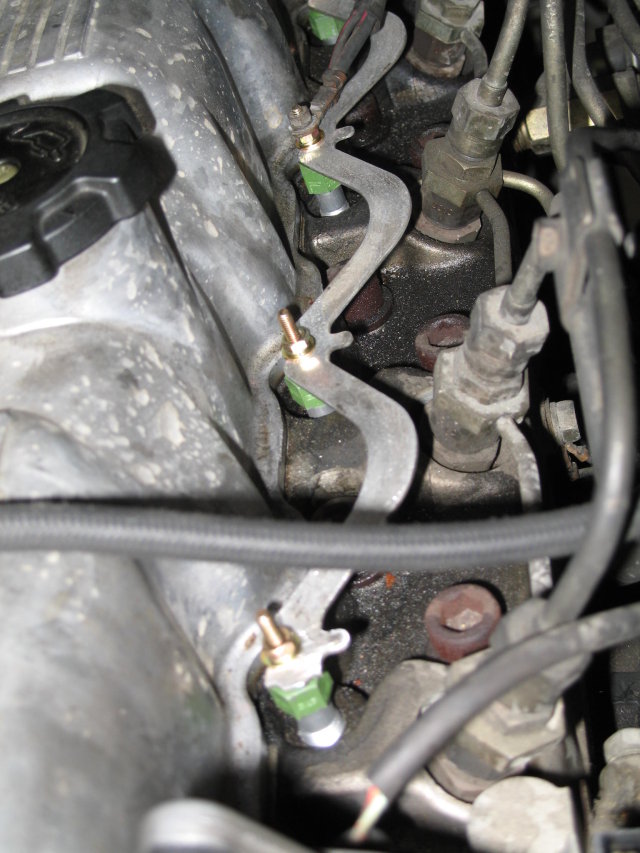

And this last image is the four glow plugs replaced, the bus bar brushed up and everything ready to go! The last thing to mention about the repairs is that the Mitsubishi plugs don't thread all the way down to the shoulder (the green part)--some of the threads are still showing, but Glen assured me this is normal.
Cleaned busbar and reinstalled.JPG (110.82 KiB) Viewed 4278 times
So: one new temperature sensor, one exchanged ECU (thanks for noticing that one Paul/Glen), four new glow plugs, half a tank of fuel equals the sound of a properly-timed second click!
