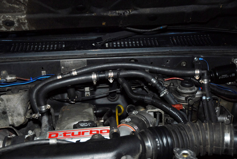

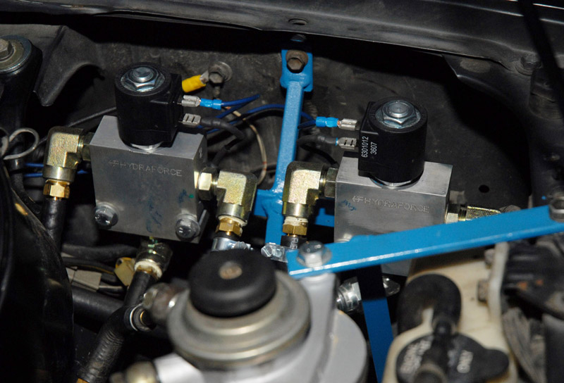

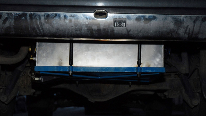

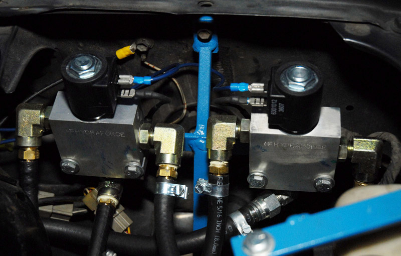

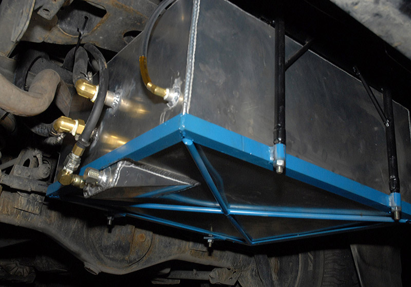

The reason I ask is I am putting together about 20 kits for a company with a bunch of Delicas and want to know if you guys are happy with the ones available. I am based out of Vancouver and my plan is to make a custom 1/8" wall aluminum fuel cell for the WVO that sits under the rear where the spare tire is. I know that there are many kits available but none of them have tanks for delicas. I also see issues with some of the kits, like using the cheap, not dependable pollak valves. The valves in my kits are the high quality hydraforce 3 port valves with viton seals that can survive high temp WVO.
Anyway I don't have a delica but I have put kits together for Hilux surfs like the one pictured below.
I feel that if I can create a bolt in aluminum fuel tank, quality parts and 'idiot proof' installation instructions along with competitive pricing then they will do alright. What do you guys think???

Cool, that's a very professional, solid looking system!! Nice. Even the brackets look great.

Also the heat exchanger in the tank will be a copper tube loom, I have about 6-8 feet of 3/8" pipe running throughout the fuel cell in my truck and it works very well. No 'Hotfox' is necessary especially when combined with a Vegtherm. The outside of the fuel cell actually gets hot rather then warm to the touch!!!! not bad in my eyes.
I am aiming for 1100-1200 with an aluminum fuel cell...fingers crossed I have done the math right

I will be making the tank to fit under the rear where the spare tire is located. I was lucky enough to go take a look at Delicat's Delica and it just doesn't look feasible to place the tank where the exhaust is. It can be done but to make a 'bolt-in' tank in that location would be next to impossible without welding onto the unibody frame (custom installs are possible though...)
The tanks will be approx. 20"x30"x8" and hold about 20-21 gallons.
let me know who is still game with the tanks under the rear as well as if there would be interest in a bracket that relocates the spare to the front of the vehicle. I realize this will block the fog lights that many of you have but I still want your input.
