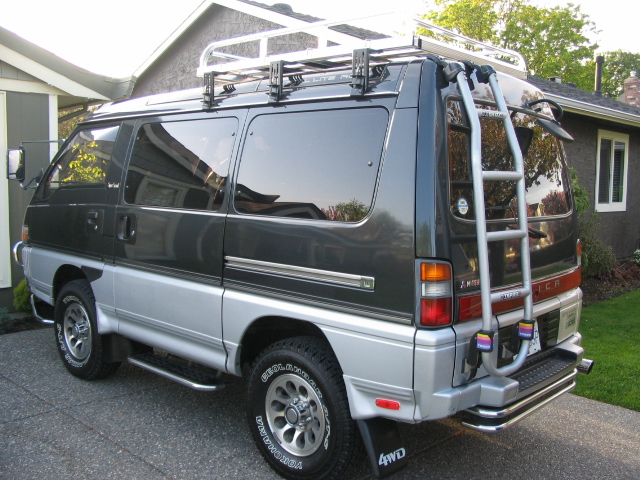

We have done mileage checks in our first 3 tanks and come up with a respectful 23.5 miles per gallon(city)Not bad for a tank on wheels ! Looking fwd to running down to oregon next month on I-5 to compare. I see that the usual config for fuel tanks on these vehicles is 1 60 ltr and 1 10 ltr in series. We have only filled up 3 times since we bought it and have yet to fill over 47 ltrs.That was with the low fuel light on for aprox20-30 klm.(Dont have the guts to try furthur than that!) Maybe we have a oddball tank or a huge reserve of 20 ltrs.Also we are getting alot of black smoke on acceleration but I read thats the nature of the beast.It flew through aircare and seems to be running great.(The smoke screen is a GREAT tail gate deterent ,3/4 throttle and people seem to back off in a hurry) Any imput on the fuel capacity would be appreciated (Ive read all the black smoke forums and dont think I have any thing to worry about) will be taking it to cvi soon for a tune up before our trip. Thanks Paul M.

I dunno, Hazel doesn't make any black smoke. I bet your CVI tune-up will put an end to it... Have a great trip!Also we are getting alot of black smoke on acceleration but I read thats the nature of the beast.

The fuel tank is manual has one tank, automatic has 2 tanks, you can see them peeking out behind your step below the sliding side door. Black smoke is very rare, from experience in all the convoys and trips for the local delicas. But CVI will sort it out. Take a list of your questions written down so you don't forget to ask. Cheers, Christine.

Beautiful deli, our colours are the reverse, dark lower, silver upper, rear basket instead of roof basket.
