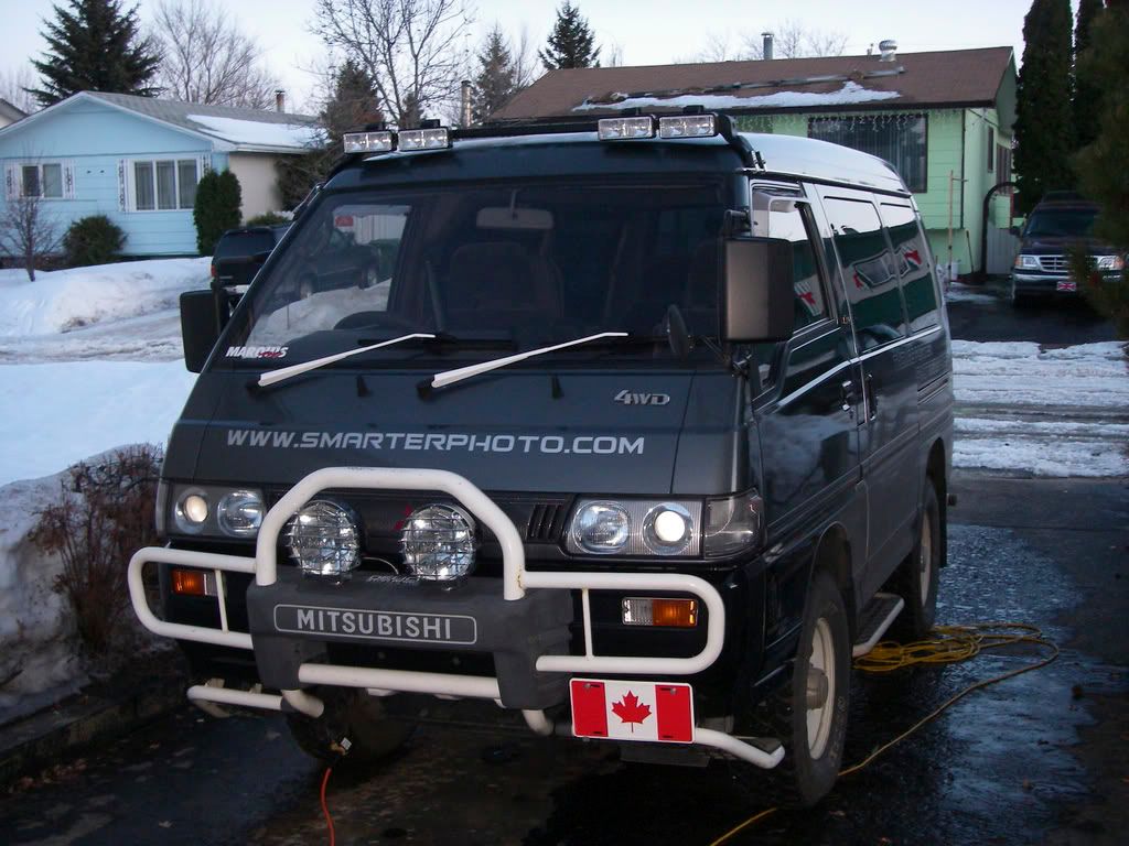

Pix finally
Post by Thomas Porter »
Photos finally, sorry about the delay. haven't posted pix before.
Thomas
Population Density; One person per square kilometre. Just the way I like it...

Post by Fanny Bay Delica »
That is a sharp Deli my friend!!!! :mrgreen: :mrgreen: :mrgreen:
Cheers!!
Andy

Post by crushers »
Thomas Porter wrote:Photos finally, sorry about the delay. haven't posted pix before.
Thomas
nice ride!!
