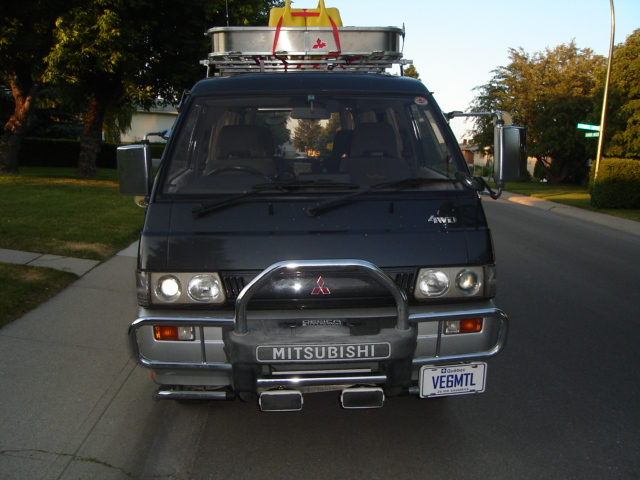

The factory foglights have been replaced by low-mounted Hellas. I didn't end up having time to mount a set of Hella driving lights where the old fog lights were, but we don't expect to drive much at night. Note the MitsuMaple on the rack.

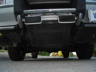

The underside has mesh (1/4") protecting the 3 rads. Didn't manage to figure out how to protect the oil cooler in the centre, will have to keep fingers crossed. When we are in Vanc, we hope to replace the centre mesh, or supplement it, with the infamous skid plate that Delicat and fishslapper are working on.

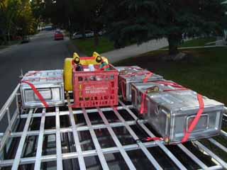

So far, 3 surplus ammo cases are strapped down. They got a coat of silver paint to reflect the sun some, and if it wasn't for the red straps, they would blend in nicely. Yes, when I get home again, I'll U-bolt them on to avoid the straps. The three cases have extrication gear, tools, and spare parts. Two jerry can for spare fuel, and a milkcrate for w/w fluid, coolant, oil, fuel treatment, and Coleman fuel fills up the centre. Another ammo case and second spare tire will take up much of the rest of the space. Special thanks to Green1 for the use of his spare and ladder (also not yet mounted).

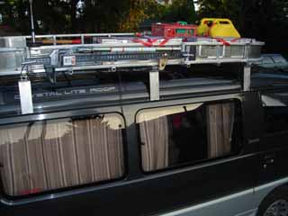

On this side, mounted to the outside, is a high-lift jack, something I really really hope we won't need. Above it is a mount for a magnetic ham antenna. The problem with aluminium racks is that magnets don't stick to them!

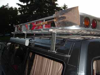

On the other side is mounted a spade, also hopefully to not be used. On the mounting arms of the rack above the sliding door, is a Shady Boy awning that folds out to 6'x10'.

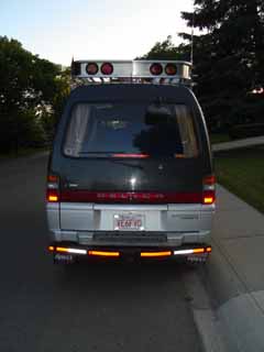

A shot of the rear. The trailer hitch runs full width for added protection, and the conspicuity tape make is more apparent. Since I spent so much for the rack, I added LED lights, amber and red up there. Now there is no excuse for someone to not see me. And with LED brake lights, they come on quicker, for further safety. Also, if driving on a dusty road there is a better chance that the high lights are still visible above the dust.

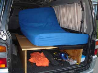

Thanks to TardisDeli's original platform idea, with some modifications, a platform that also fold compact, replaces the 3rd row seats, provides the basis for the bed, and provides (hopefully) ample storage underneath.

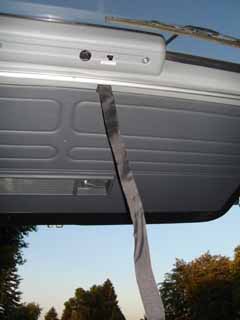

This is the view of the tailgate. While lying in bed, it is impossible to close it. So I added a strap -- not quite what I wanted -- so you can reach out and grab it to pull it down. Also visible is the round hole that gives access to the lock button. Beside it is a 3 way switch that controls the lights. Either gate controlled, just on, or simply off. So you can sleep with the hatch open with the lights off.

Hey sorry if I jumped the gun on your post. It looks like your van is very set up! I really like what you have done with the remote light switch on your rear hatch. I also wondered how I could close the door from the inside. I ended up getting Glen from CC autos to send me a roof handle it wasn't easy to mount solidly but I worked it out!
If you look closely to the top left of the picture you will also notice a little rectangle that I have cut out of my tint to facilitate seeing the rear mirror.

asorensen wrote:I also wondered how I could close the door from the inside. I ended up getting Glen from CC autos to send me a roof handle it wasn't easy to mount solidly but I worked it out!
I've also added a nice (Lee Valley Tools) handle in the bottom corner. Was going to add a second one where the strap is, but it wouldn't fit. So now I'll add it in the other corner. It is handy for closing the hatch when standing outside, the strap is handy when lying in bed. At least the Delica already has in interior release for the hatch, previous vehicles I've had to rig one up.
