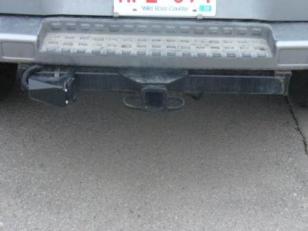

I had my done in Apr by The Welding Shop (273-7717) for $345 + GST, included the tongue but no wiring. Was able to work around the spare (very tight). Removed the old tube bumper (know anyone who wants it).
Got the wiring done at Hitch Warehouse (291-3566) $126.14 GST in, with Ball.
Have pictures just I can't figure out how to add them here?

Ok so picture worked

If it's chrome, advertise it in the Parts section of this forum. Someone snapped up mine when I put a hitch on the back of Moon Machine.CrazyFamilyof5 wrote:...[r]emoved the old tube bumper (know anyone who wants it)?
Nice looking hitch assembly, BTW.
