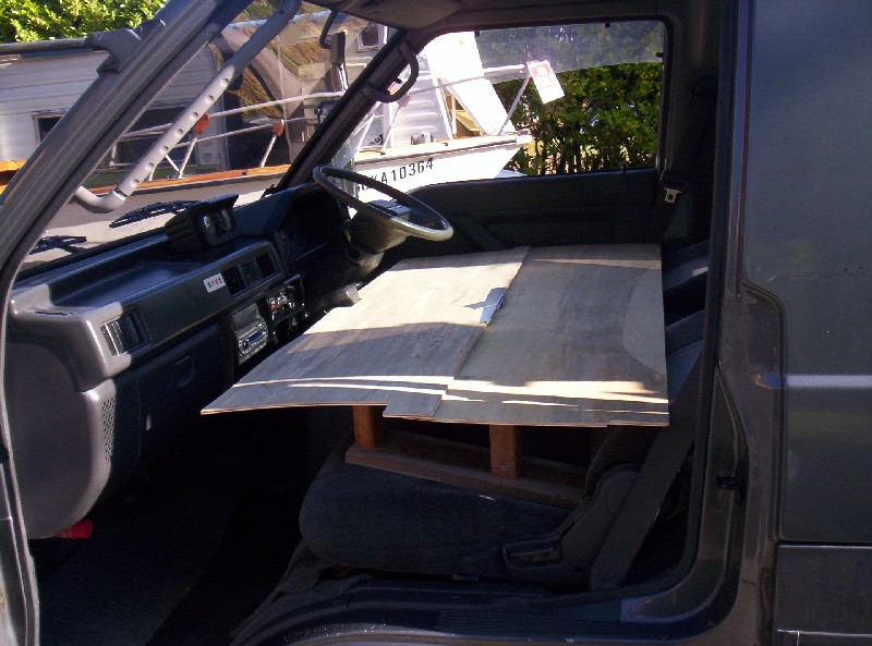

As was asked, here's pictures of our front bed in our old Delica. Has worked very well, even Randi has laid on it to relax. The door skins originally had a upward curve, allowing the front doors to be opened and closed well set up. Moisture has curved the plywood the other way, requiring the bed to be held up to close the front doors. Not a problem as we have always loaded the bed from the back, where the parts are stored. The plywood ends rest on the doors arm rests.

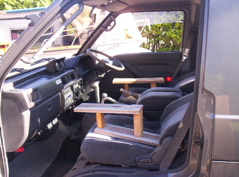

- Bed supports in position

Thanks guys, our first westie came with the hardware but no hammock. It was quite a easy thing to build for the westie, but so was the one in the Delica. The Delica bed I made was bigger and easier to get in and out of then the westie front hammock. This bed, with a 4 inch foamie, doesn't have much head room already; but if your kids are small it'll certainly work. Please post some pictures!
