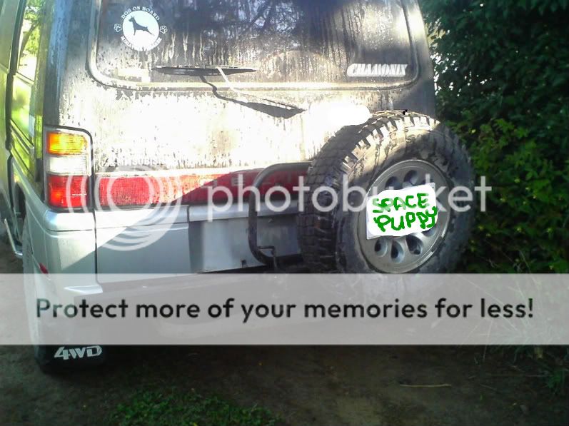

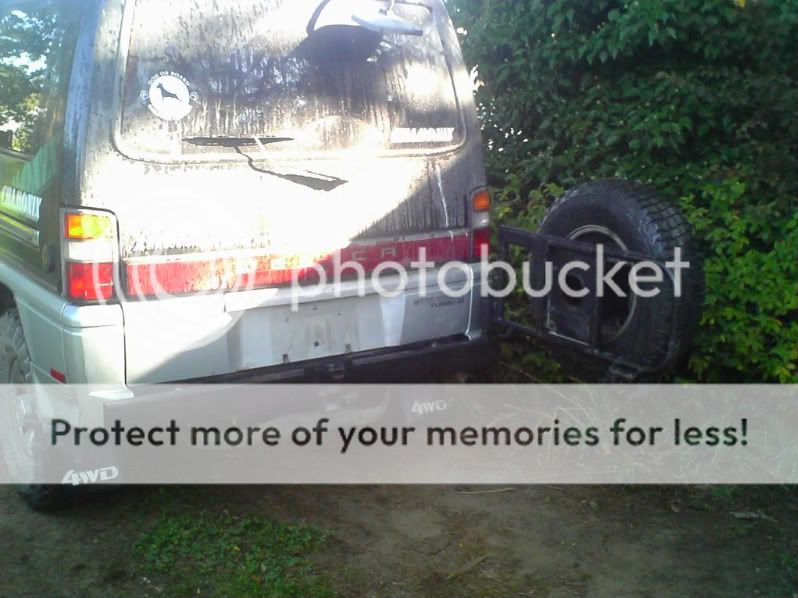

bcdelica: its kinda like posting pictures of your children.. youre so proud!
Re: space antelope WVO install
Nice looking spare mount for sure! Great project all the way after oil. Since you are soon to be burning pure WVO, will you still blend your diesel? Love the "Dog on Board" sticker btw - Radar sounds like a cool guy :M :-D
Just had another look at your spare mount (when having another glance at the dog sticker :-) ) and I noticed your licence plate is mounted in the center of the spare. I'm pretty sure the plate is required to have a lamp shining on it... :? :M :-D
