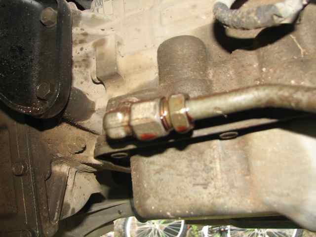

Hey there, I seem to be losing quite a lot of fluid from this connector at the base of the trans.... I am wondering if it would be as simple as unbolting it, replacing an o-ring and rebolting it. If anyone has a tip for me thanks a lot. For now I'll keep an eye on the fluid levels.. It seems like a leak directly at the connection, not a cracked gasket or anything too serious.
MAtthew
Re: Leaking Transmission Fluid
Manitoba Delica wrote:I am wondering if it would be as simple as unbolting it, replacing an o-ring and rebolting it.
You got it. :M
