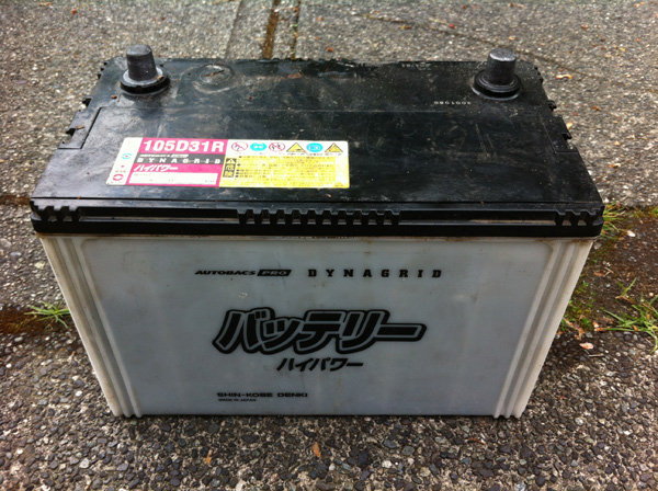

Does anyone know the specs on the Dynagrid 105D31R battery from Japan? It's probably the one that was in my van when it was imported, and a mechanic told me it's "undersized for that vehicle." But I want specs so I know I'm replacing it with something that's an improvement.
WFIW, the Dynagrid is working just fine, though I don't typically drive in sub-zero, so I'm not asking it to work too hard.

What I'm using now is Edmonds Batteries (in Burnaby), giving me a combined 1500 cold cranking amps between the two batteries (in parallel). Not deep cycle but pure starters. They are good with the pricing, as well and were very helpful to me. When I first got my wagon, I went to a place called Performance Car Stereo to get my stereo installed. Once it was in we listened to it for around forty minutes in the shop, without the engine running. Then I tried to start the motor and it wouldn't start. I couldn't understand it because the volts were fine when I checked them. It was then explained to me that, although the volts were fine there were not enough amperes stored in the battery. I suspect your battery(ies) are like the ones that came with my wagon ~ just enough to start in temperate weather. I'd recommend getting replacement batteries and I would favour Edmonds over Polar, IMHO.

I'm considering Canadian Energy, who will sell me a Korean-made P27RW battery for $121.54, exchange.
Canadian Tire sells a USA-made MOT27 for $130.
Not sure which of these is the lesser of two evils.

The Edmonds Batteries are US made, cost me less than two hundred bucks for the pair and the warranty that they gave me was for eight years, the first three at 100%. I don't work for them and I'm not getting a kickback, just think they are a very good deal worth looking at.
