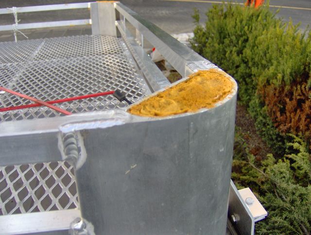

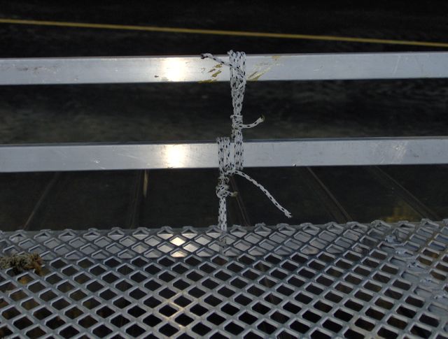

Oh yeah, I can relate, TOTALLY!! :o When we first installed the rack it HOWLED badly even at low speeds. I figured it was the hollow tubes in the corners acting like Pan-flutes, so I filled them with expanding foam - messy, but effective. Then, a few months later (last week) the rack started to howl again at about 80 km. I went up there and tapped the cross pieces which resonated like a tuning fork! I envisioned drills and bolts or getting a welder involved, but ended up simply tightly tying the cross pieces together - works.
Messy but effective expanding foam filler.

A simple tight tie job to quell the resonating cross pieces.

So the consensus is the sound of the air shooting threw and around the bars slightly bending them back and forth in the wind? I should put down a center beam in mine then cause mine has lots of wide lengths.
Re: wind loud threw roof rack
Like I said above, in our case it was two separate issues - 1 was the tubes acting like a bottle when you blow over the top of it and the other was the cross members vibrating like guitar strings causing the whole bus to resonate like a gutitar body! So, if your rack doesn't have any hollow tubes then the noise is likely the guitar string scenario. Climb up there and tap the cross pieces until you find the one(s) that ring. I bet it will be (was for ours anyway) the front and back pieces. A centre beam should help for sure. You can just use a bit of string like I did in the picture above to test it and see if the noise stops by securing the cross pieces. Good luck and let us know how it goes - and any chance of a picture or two of the roof rack? :M :-D
