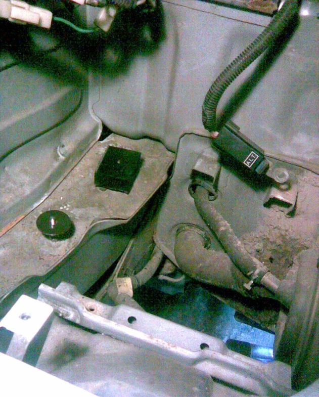

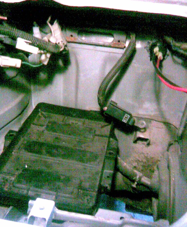

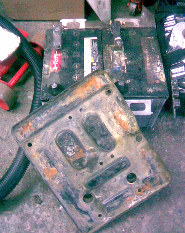

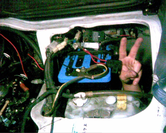

My truck still had the original Japanese batteries that were getting tired so after a long time trying to decide on my options I went with a single deep cycle gel battery.
The old.jpg (223.9 KiB) Viewed 7046 times
This particular one is similar to the Yellow top (Optra, Optima?). It's a deep cycle rated at approx. 110 min reserve and 920cca. I guess it's not a real deep cycle as it has good cold cranking amps, these are typically used on 4x4 vehicle with greater demand for extra lights, winch...
Jay (Tardisdeli) showed me his skills and innovation on this one. Thanks Jay!
We decided to ditch the old tray and replace it with a single plastic tray (Marine application) and were able to fit it by only using existing taps. The tray was installed toward the driver's side as the frame rail is underneath and not much space could be used below.

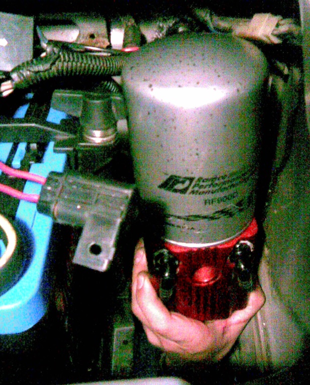

Doing so gave us a big opening that may be used to mount my WVO filter. I already had a bracket made to mount it behind the front passenger's side wheel (thanks EricN!) but this way might make it easier for access and line routing. Also, if Plantdrive can't figure out how to get us new filters than the extra space would alloy me to use a narrow Racor heated filter (or so I hope!).
Filter location.jpg (238.18 KiB) Viewed 7024 times
All in all a very clean install. I'm not worried about having this opening unsealed as I the rest of the engine bay isn't seal from the bottom...

One thing I realized is that now the starter spins like crazy (in a good way) so really no need to hold the key for more than a fraction of a second, very nice!

Hmmmm. Makes me think I should replace mine. The last time I had my oil changed at the shop I had them test my batteries. They said they were "ok". Not sure if they are the originals but they are Japanese for sure. I will have to ask Mardy. What do you guys recommend for a Deli living in Winnipeg? Is it difficult to switch to a single set up?
Rob
Re: Battery tray mods
Quite easy to change to a single set up but if you're from Winterpeg I'm not sure I'd go with a single set up, I'd probably do like Falco did and get two decent batteries to replace the old ones. That will give you better cranking on those cold days...

do you have any clearer pictures on changing from the 2 battery set up to one? im gonna have to do this, looks like it should be simple but im not sure.
