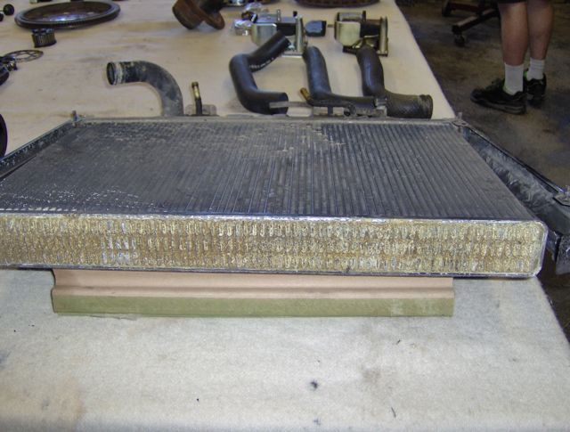

While you're changing the coolant, inspect the radiator carefully.
Any sign of corrosion inside, either replace or get it re-cored.
It's much cheaper than getting the head replaced if corroded stuff gets loose and blocks the coolant lines in the head.

Would you also recommend using a radiator flush like the ones they sell at Canadian Tire?

No kidding - here's an example I have posted before of a display at the ccautos day this past Aug. Nasty. Use a flash-light and have a real close inspection. Don't do any type of chemical or physical flushings if you see any sign of calcium build up but rather like Jester suggests, get the rad restored. If you do flush a blocked up rad you run the risk of loose bits breaking free and making a bad situation much worse. Once the rad is "new" you can flush regularly as a preventive maintenance thingWhile you're changing the coolant, inspect the radiator carefully.
