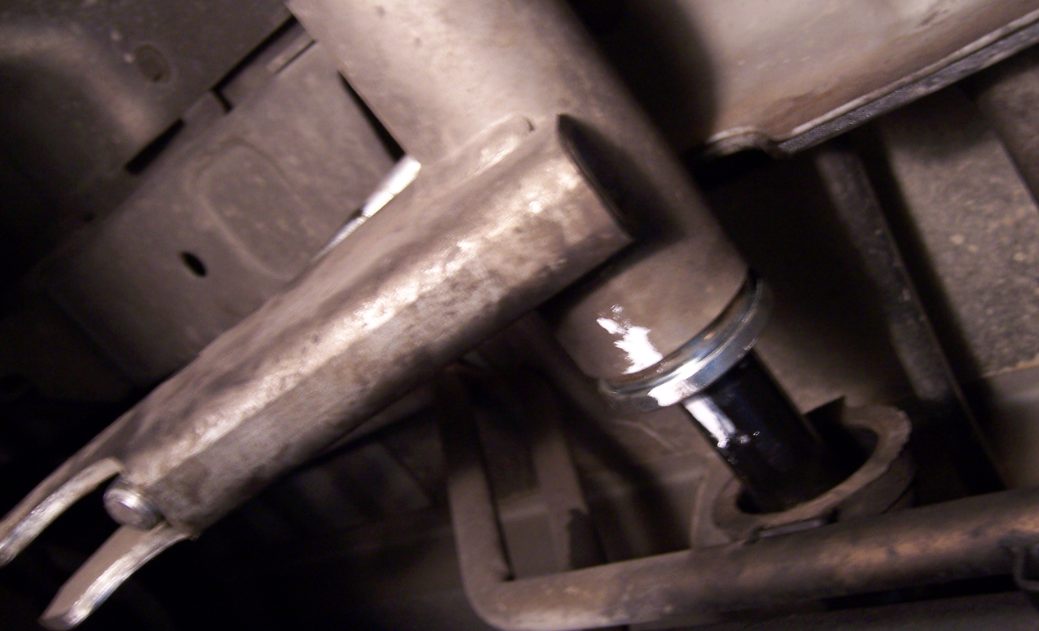

-Remove the two nuts on the adjuster's bolt using a 17 wrench or extension tool. (the bottom of the picture is towards the front of the truck)
Driver's side torsion bar.jpg (67.28 KiB) Viewed 12872 times

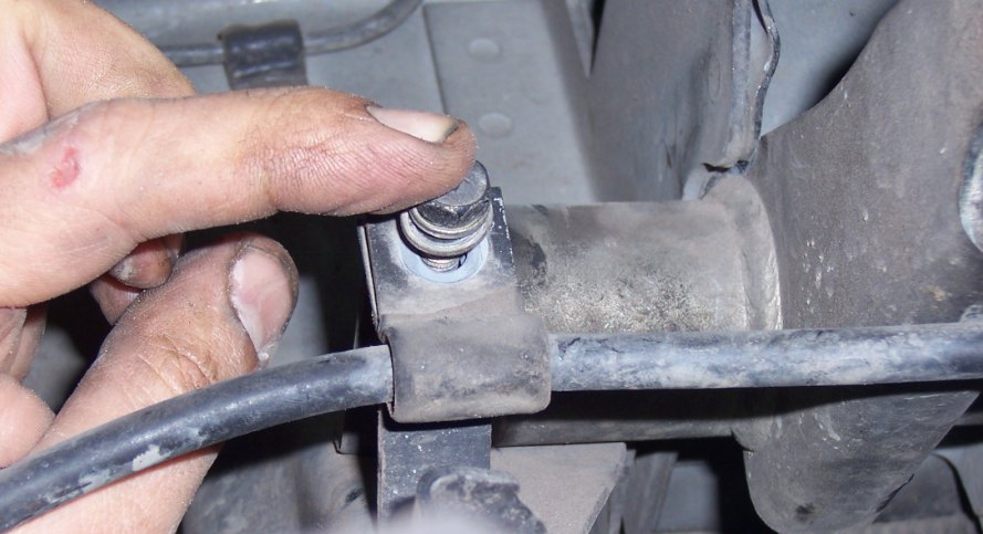

-See this bracket that holds that black line? It's in the way for your job so...
Trouble brackrt.jpg (84.17 KiB) Viewed 12866 times

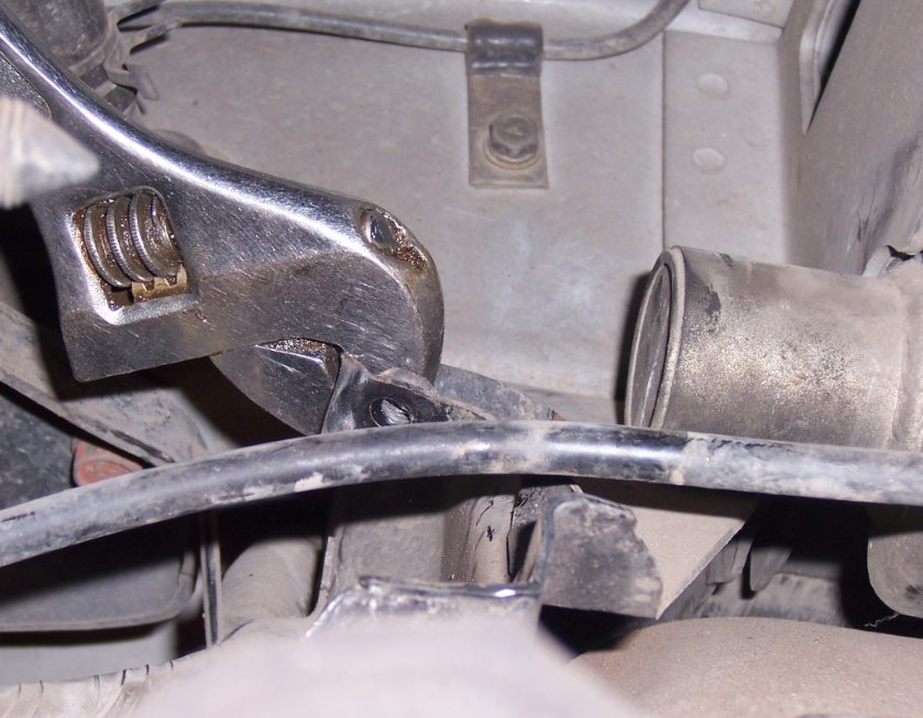

-Got to pry it out of the way. Here's the easy way to do it:
Pry it out of the way.jpg (108.17 KiB) Viewed 12871 times

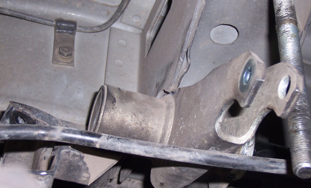

Way out of the way.jpg (95.72 KiB) Viewed 12860 times

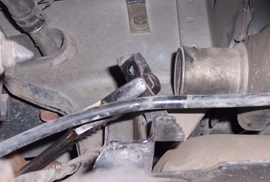

-Now you have room to pull the adjuster out of the torsion bar.
Room to move torsion bar passenger side.jpg (111.4 KiB) Viewed 12869 times
Trouble brackrt.jpg (84.17 KiB) Viewed 12858 times
