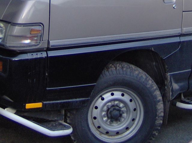

FalcoColumbarius wrote: if you can't find that there it is likely because you have manual lockers and where the auto lock sign would be is a switch, in which case you have to get out of the van (don't forget the E brake).
Or perma lockers that cannot be unlocked, so you see you can drive around with the hubs locked but not have the transfer case in 4x4, no problem. Almost certain that delicas never came from the factory with manuals - just auto lockers or perma locked. We had the perma locked hubs but had them switched for manuals, which, I might add, can be engaged without getting out of the vehicle - Ahh the joys of cab over!
What perma locked hubs look like
steel rims.jpg (43.16 KiB) Viewed 6060 times
