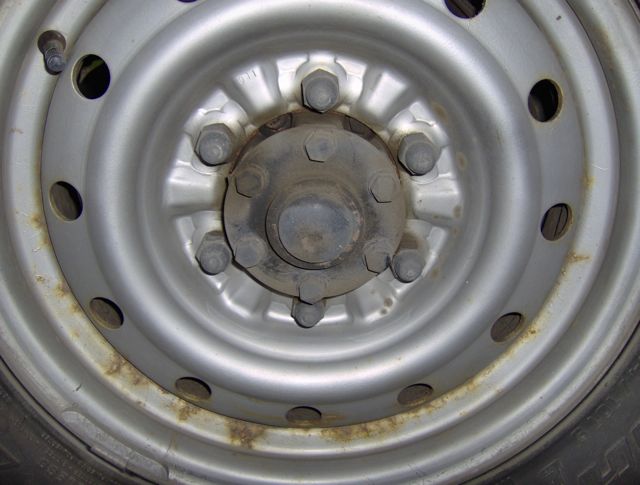

Re: hub lock question
jfarsang wrote:In fact, some of the 2nd Generation Pajero/Delica's come with flanges which permanently lock the hub instead of the auto hubs on Gen I Delica's.
Our 1992 GLX delica came that way. They look different - check the picture. Didn't know they were called "flanges" I just called them perma-lockers. A little more wear on the bits and pieces down there, and no option to use the low range grears in 2wd, but hey, ya can't do that with the auto-lockers either - Made the switch to maunal hubs and was hoping for a fuel savings, but as ccautos Glen predicted, it made no measurable difference in fuel economy. Love my manual hubs all the same though. :-) :M
