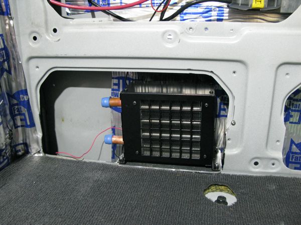

We recently installed an auxiliary coolant heater in the rear. Right where the heater vents used to be. If all goes well, it's going to be connected to the Espar heater soon. Just need to finish up the mounting box.

How is that different than the coolant heater that was originally back there?fexlboi wrote:We recently installed an auxiliary coolant heater in the rear. Right where the heater vents used to be. If all goes well, it's going to be connected to the Espar heater below. Just need to finish up the mounting box.

The heater/fan is not really different beside the outside dimensions are way smaller. The heater core is similar in size. The main advantage for us is, it frees up a lot of space underneath to install the Diesel heater and the hot water tank.

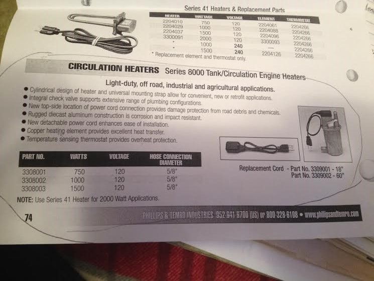

All - searched in detail and could not find a picture on forum of an L300 with the circulating heater install. I am picking up my Phillips & Temro 1000W Circulating Heater at Lordco Kamloops tomorrow on way from Vancouver to Canmore. Would appreciate it if anyone could direct my to an installed L300 Circulating Heater-Rad Hose splice on the forum to help me out. Also - where should I bolt the heater too, anything else to consider to avoid coolant leaks? Most of the conversation on forum around these is back from 2008-2009. I have a 1991 L300 Chamonix that is stock. Quite a bit of room near to the oil pump in the engine compartment side for potential mounting if I remember. Look to install on 28th or 29th.
FYI - if anyone is thinking of doing this talk to Cameron at Lordco Sydney who is very, very knowledgeable on these and gave me the part sheet I have linked below in picture. - 250-655-9311.
The Phillips and Temro circ heater I am getting is in the picture below if that helps. Understand most people are running these. Thanks in Advance!
Andre - 6x4 - 8(three)7 two(nine)9[five]
http://i820.photobucket.com/albums/zz12 ... dlta5g.jpg
Trying to keep my Van from freezing like last time I was in Canmore! Have the magnetic oil pan heater but that is not enough!
