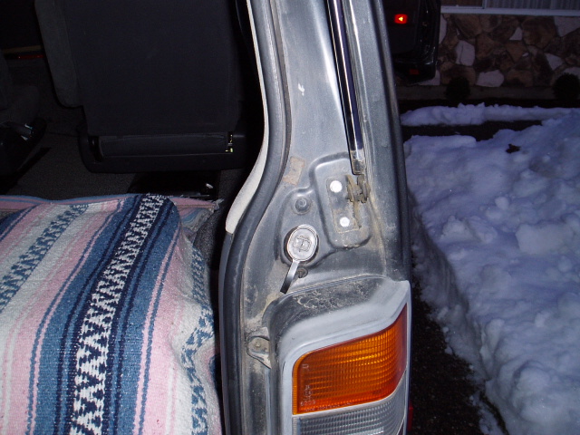

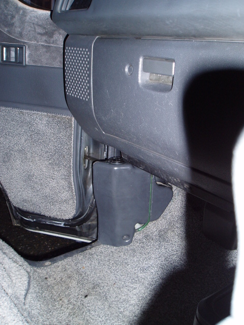

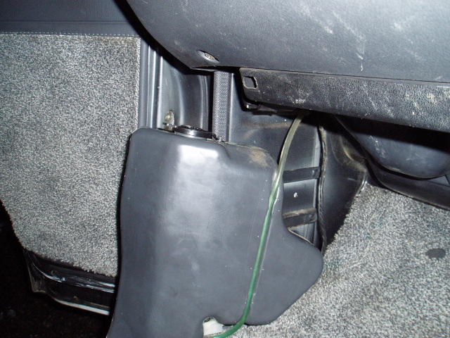

Pictures for all to see :-D
front
front
Duke 007.JPG (142.06 KiB) Viewed 5026 times
rear
rear
Duke 008.JPG (142.73 KiB) Viewed 5026 times
front again...... just cause I can
Duke 006.JPG (146.67 KiB) Viewed 5024 times

the front one does have a screw at the bottom that needs to be removed before it will come out though (before you start using a crowbar on it :))

loki wrote:he front one does have a screw at the bottom that needs to be removed before it will come out though (before you start using a crowbar on it :))
That's what I was told too, but found the screw on mine was pretty much frozen, so I gave up and resorted to the funnel. When I found Bruce's post on the UK forum today I noticed there was no mention of any screw so I went out to the bus and whatdaya know, the thing just slid out like Bruce described!? Easy-peasy :-D :M

Sorry, no screw holds the bottle on my van, if you look at the first picture you can see where a screw goes but that holds the pump motor. It's held in pretty tightly on the clip. Where I bought the van, the owner went over damn near everything, this was one of them. :-)

I stand corrected, my is a hard pull to get off anyways so taking out the screw just make me think it should slide after that :). I think I will put a little lube on it next time so it's a tad easier to get back out.

The first time I tried removing the bottle I took out 2 little screws and, that I didn't know at the time, but that removed the pump and all the fluid came out. Had a little flood in the garage - good thing for dog towels! :shock:
