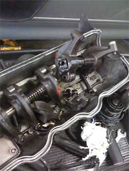

After waiting a while at the border Bayview Towing (awesome company which only does recovery stuff) I got the van back to our mechanic in vancouver. BCAA RV Plus was a huge asset, saving us roughly $600 in towing fees.
It turns out that a timing belt rotor failed which caused all hell to break loose. Bent valves, one broken cylinder head, sheared rocker arm rod (I think that's what it's called). Pretty frustrating. The van as 130k on it and the timing belt and rotors were replaced at 109 when we bought it.
I am now less confident when we take it back on the highway. Bummer.
- the sheared rocker arm rod thingy

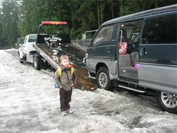

- the tow truck driver towed us off the I-5 shoulder to a rest stop where we got into our cab

Bummer indeed,
It seems every time this happens it erodes everyone's confidence in their own machines, at least it does me, and I as well had the T-Belt done as soon as I got it. While we may be able to go into denial and hope the original mechanic that did your T-Belt fubbed it in some way, we'll never really know will we?
What is the 'timing belt rotor'? Is that the tensioner pulley?
Thanks for the follow-up, hope the rebuild goes well.
