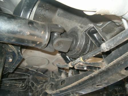

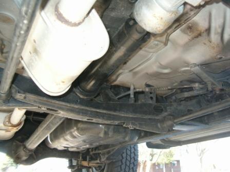

Hey, got some pics.
1. shows the driveline from front to rear
driveline-front to rear.JPG (23.61 KiB) Viewed 5514 times
2. shows the carrier bearing and the shaft from bearing to rear axle.
bearing and rear axle shaft.JPG (26.58 KiB) Viewed 5529 times

Re: Carrier bearing replacement
Got it.
Haven't seen one of those for a while.
You may have to have the bearing pressed off/on by a shop.
It's a high load bearing so the cost is normal.
