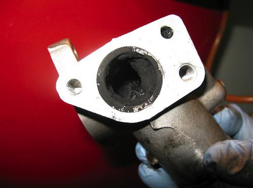

And here's a picture taken by Fexlboi that shows the elbows leading to the intake manifold. That pictures is a good enough reason for me to ditch that EGR! I'd rather have a cleaner engine by removing the EGR than looking at that picture!
Hope this help!
