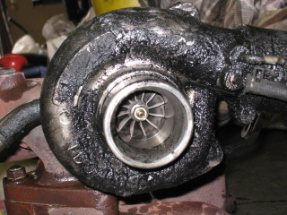

- Turbocharger BEFORE !

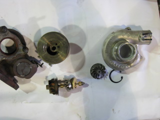

- Turbocharger components after "SONIC" Cleaning.

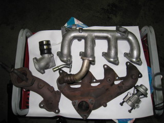

- Instake and Exhaust manifold & components after cleaning.

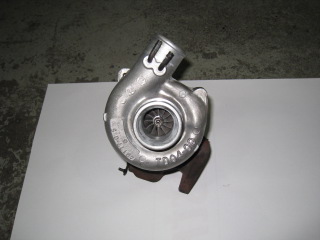

- Turbocharger AFTER !

Just curious,
When you say "Turbocharger overhaul", do you mean you're replacing worn out parts like bearings and seals or just cleaning the turbo? 'Cause if you're doing a full overhaul that's a real good price and I'll have to start saving money!

I am not An employee of cvi but to answer delicat....
I believe butch said to me that this includes all new seals and bearing And ultrasonic cleaning etc...etc.. Not just worn parts !! I know, it does seem like a great deal with all the parts al labour !!

We do a complete teardown of the turbo, check for bearing condition and replace it if necessary. Carbon seals and housing where it seats are all sonically cleaned together with the master assembly housing, turbine and compressor wheel. All seals are replaced. As this components spin at around 85,000rpm at full load, it is a very delicate engineering piece of art.
As we have encountered a number of manifold gasket failures in the past, we have taken the necessary step to take care of this problem by replacing the old gasket to the new metal gasket from Mitsubishi OEM Parts. And while we're at it, we sonically clean the EGR valve too as they have been known to fail as well. These takes care of the Preventive Maintenance work needed on this side of the engine to perform at its best without worrying about this things failing in the future. Peace of mind and knowing that all is well on the power plant makes driving our delicas more enjoyable.
