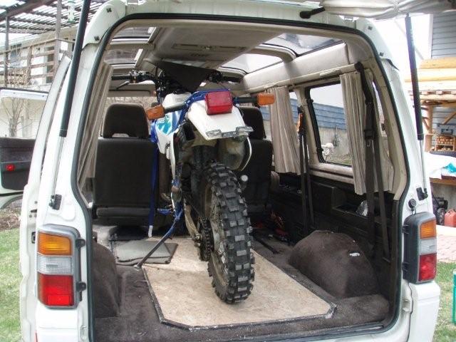

thanks for all the info, i ended up loading my bike in the back of the van this time, but i'm looking into buying a trailer because i'm not allowed to do that again.
