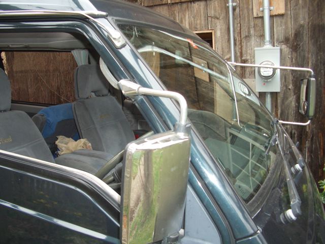

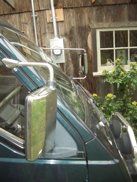

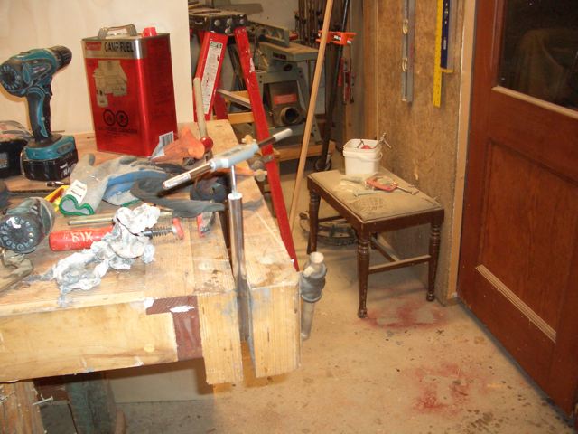

Ok I'm all about the bling, made a new mirror bar with solid aluminum stock ,it took a bit of jigging and fiddling but not bad for a prototype, hacksaw , file , drillpress, tap and some various sundries , gonna pickup some more aluminum tomorrow and do the passenger side , I'll take some pics as I go to show the process.

I'll have to catch up with you to see what you've done: Moon Machine's mirror bars can't be re-chromed, they're far too pitted.
From the images, I now have one answer: the bar goes all the way through the mirror. Always wondered about that.

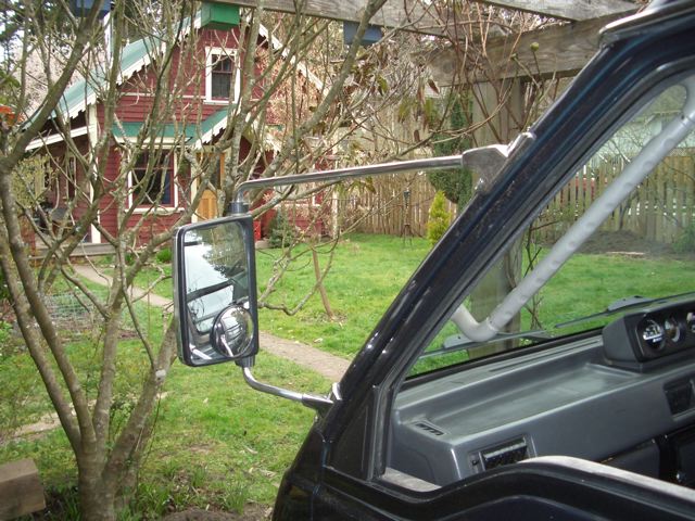

The aluminum polished up nice as chrome

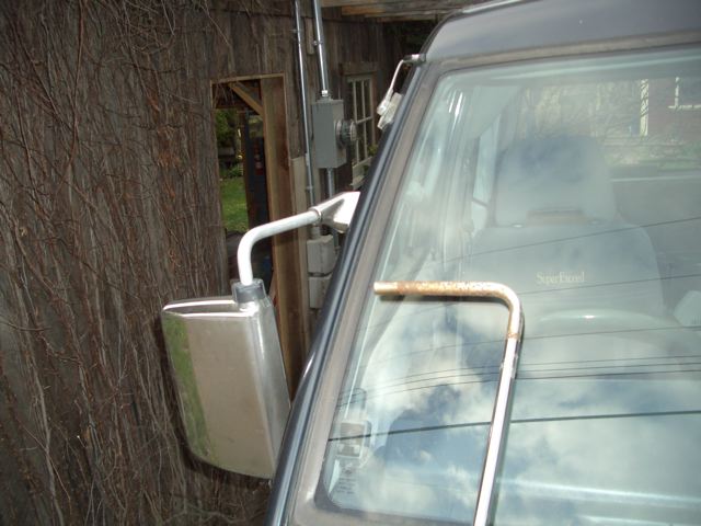

These are way stronger than stock and cant fill up with water like my old ones were
The ends are drilled and tapped for 1/4- 20 machine screws.

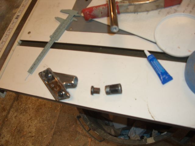

one pic shows the plastic plug that needs to be trimmed :? otherwise its a pretty simple swap the toughest part is taking the plastic bushings that are aged and decrepit :o

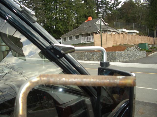

you can see the end of the drilled bar in this shot aswell
