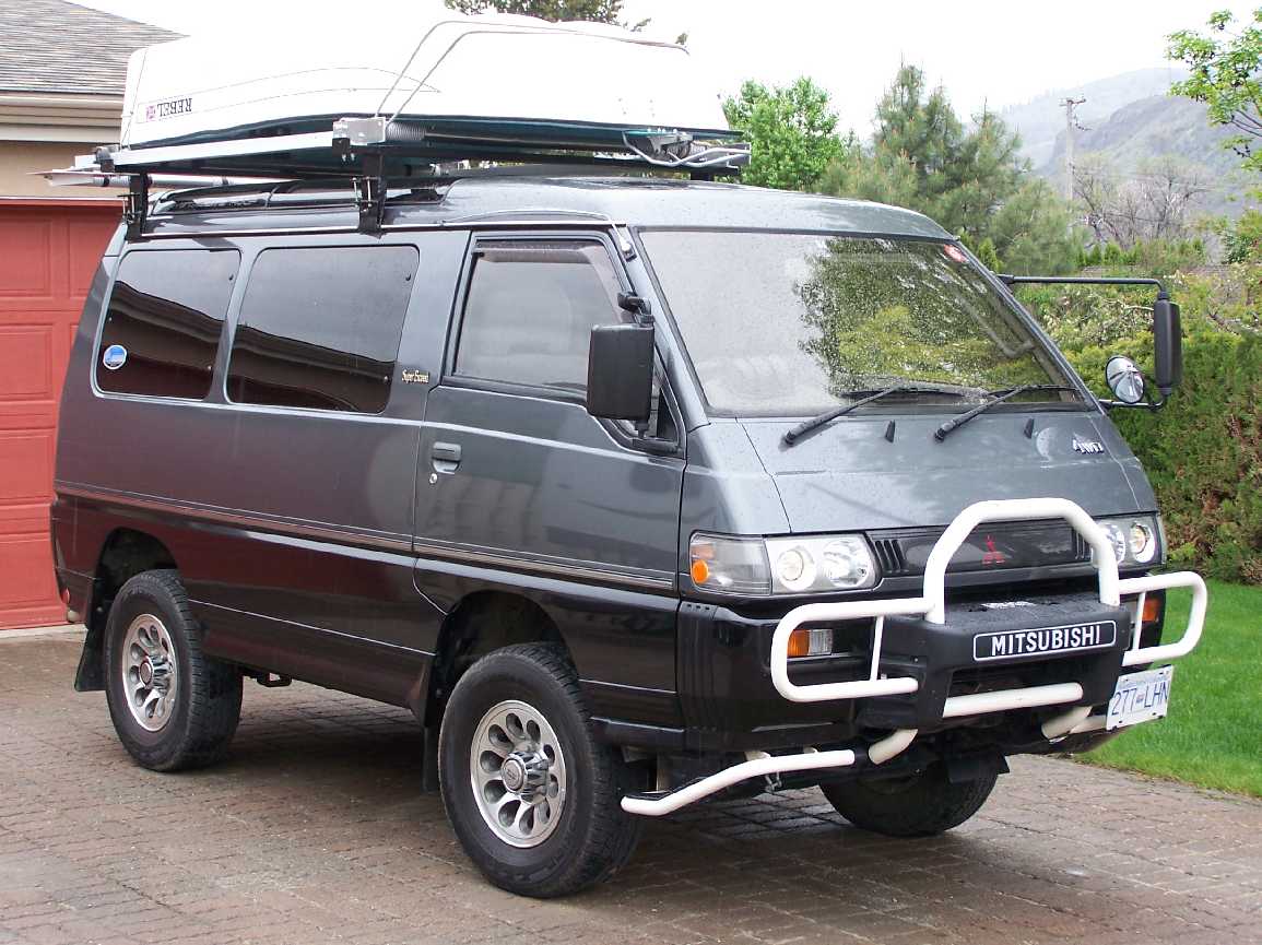

Re: High Roof Rack Supports
I used Noel's cross rack for the base to my boat loader. It was the best combination of cost and quality. Noel will also add a few custom items like extra length, End caps, and in my case 2 slugs on each end to bolt my rack to. I have no concerns whatsoever about the rack touching the roof.
Larry
Larry
- Fishmobile #1.jpg (120.48 KiB) Viewed 5834 times
