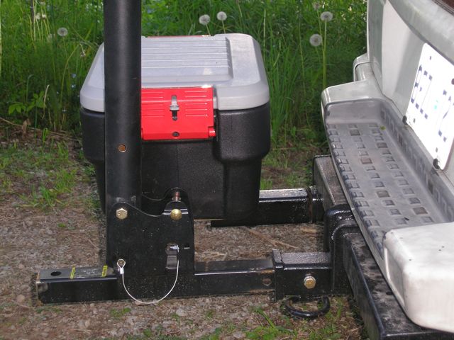

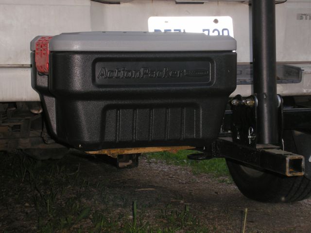

Here's my solution to all of the paraphernalia rolling around the floor in the back of the Bling Bus.
It's a standard locking storage tote bolted to a steel plate, welded to a reciever bar, and inserted into the second receiver in my hitch.
It holds my booster pack, tow straps, tire iron, extra receiver bar & ball, adjustable wrench, bungees, pan heater cord, ice scraper, etc., all of which were previously tangled in a big mass on the floor.
When I get enough spare time I plan to replace the plastic box with a home-made treadplate aluminum one.

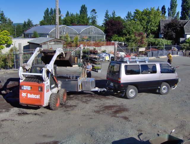

I have that same hitch and have used it everyday to drag our often pretty heavy gardening work trailer around for a year now - take Mtn. bikes off that hitch on wknds too - no problems at all. It's tilted downwards a bit (actually makes the trailer sit at just the right angle :-) ), but sure isn't "wobbly"! Sounds like yours wasn't bolted on properly - The main bolt holes are onto the main frame - totally skookum enough.
And hey Nishby - Very cool - smart - set-up with the utility box off the outside receiver like that! I'd be inspired to copy your idea but the box on our trailer serves that function for us - 8-) :-D :M
Loadin' up that trailer on the M-Drive hitch - our tool-box too :-D
