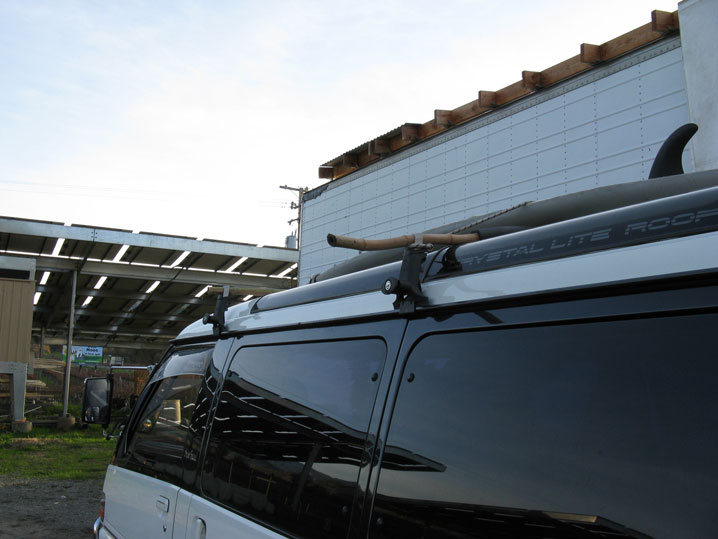

I found an old simple rack and used curved bamboo to get over the high top. And drove to Cabo, Baja and back with two surfboards. Might not be the prettiest but it worked.
- bamboo-rack.jpg (60.6 KiB) Viewed 7571 times

Thats AWSOME . I Love that.Dewy wrote:I found an old simple rack and used curved bamboo to get over the high top. And drove to Cabo, Baja and back with two surfboards. Might not be the prettiest but it worked.
I have some FAST growing giant bamboo in my yard, we were talking about weaving it into a roof rack basket, probably wont do it, but was a cool idea,
