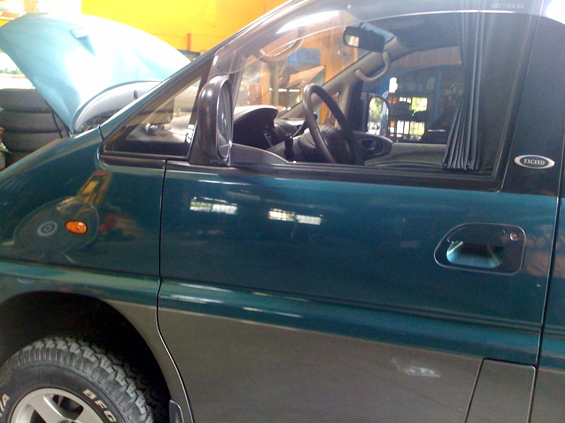

I was just visiting some of my friends in Taiwan who owns a specialized Delica shop, I was amazed to see how their delicas were performing. I was on a Delica that reached speed of 150 km and yet the RPM was under 3000. All their delicas are modded to run like that. Mods include, bigger turbo, change exhaust to 2.5 inch, add inter cooler, tweak fuel pump, add snorkel (it sucks more air and you will need it) and i think that was all. Most of the guy over there don't like AT at all, they even convert AT to MT.
Here is a photo of Spacegear was converted LHD with a 2 inch lift.

mdrive wrote:I was just visiting some of my friends in Taiwan who owns a specialized Delica shop, I was amazed to see how their delicas were performing. I was on a Delica that reached speed of 150 km and yet the RPM was under 3000. All their delicas are modded to run like that. Mods include, bigger turbo, change exhaust to 2.5 inch, add inter cooler, tweak fuel pump, add snorkel (it sucks more air and you will need it) and i think that was all. Most of the guy over there don't like AT at all, they even convert AT to MT.
Do you know where to buy a schnorkle for my Deli Max?
