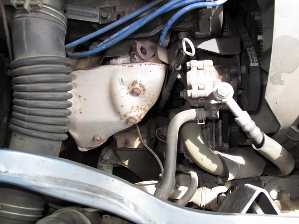

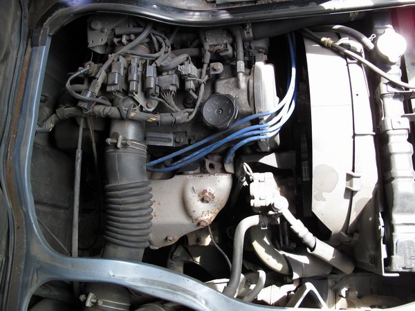

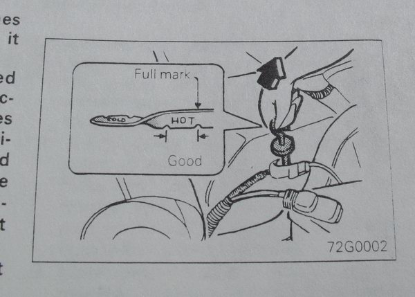

Well, I looked again, and I cannot see any sign of another dipstick anywhere near the one for the engine on my van. I have attached some images below. I have also attached the crummy drawing from the owner's manual, showing the tranny dipstick, and cannot find anything in the drawing to serve as a recognizable point of reference. The drawing for the engine dipstick is also crudely done, but you can see things like the oil filler cap, radiator, etc. This drawing for the tranny dipstick looks quite different.

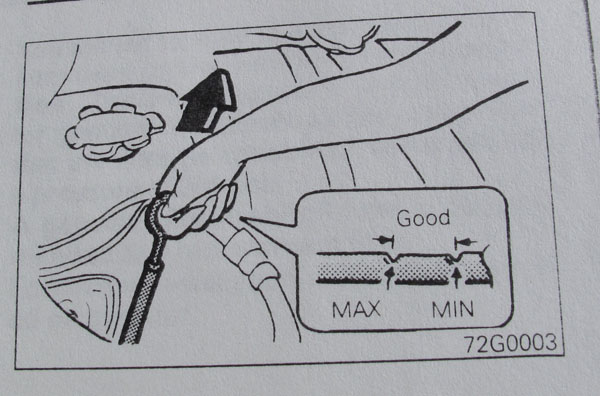

This is the drawing in the manual for the engine dipstick, showing the oil filter cap, top of the radiator, etc.

Just a guess as my gasser is manual, but that looks like it is behind the battery, and I believe Josh had to modify his battery box to get to the tranny dipstick. That square in the lower right looks like it has a battery terminal attached.

Yes, I think you are right about that being a battery terminal connection. I will check the battery compartment as soon as I get home and can look at it.

Thanks a lot, as the tranny dipstick was indeed in the battery compartment. Never occurred to me to look inside there.
