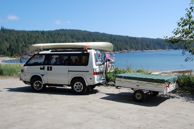

I've towed this set up across the rockies, to drumheller etc - and we do a lot of roadtrips locally. I agree with everyone so far. Get used to being the SLOWEST vehicle on the road. You will easily be passed by loaded semi's. Having said that, just relax and enjoy the scenery, and keep an eye on the temp. My very basic rule of thumb is: if I can see black exhaust in the rearview, I'm pushing too hard and ease off on the throttle.
As far as the turbo timer goes - the time varies depending on how hot it is. The longest it is on is just over 2 minutes. So, just let it idle for at least 2 minutes before turning it off when you've been on the freeway.
