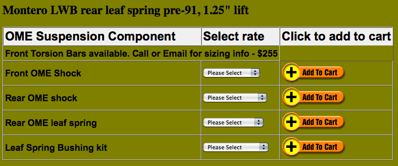

Just got in contact with ARB Australia which is the main distributor for OME suspension. They obviously don't have anything listed for an l300 but have tonnes of stuff for the Montero. Any idea if any Montero has the same suspension as a Delica? Here are a few choices: http://www.rocky-road.com/monterosus.html

Not the same....Delica is Torsion bar front and leaf spring rear. Parts listed on The ARB site are for coil spring front and rear.
Re: Old Man Emu (OME) Suspension?
Only OME things I think you can swap on an L300 are :
front shocks
rear shocks with (pin to eye) conversion kit
front torsions bars
Posts: 1671
Vehicle: -
Location: -
Post by fexlboi »
Meanman wrote:Not the same....Delica is Torsion bar front and leaf spring rear. Parts listed on The ARB site are for coil spring front and rear.
I know, but the Montero pre 91 has a Torsion bar and leaf spring rear as well.

Do the rear leaf springs of a Monty sports have the same length as the Delica?
