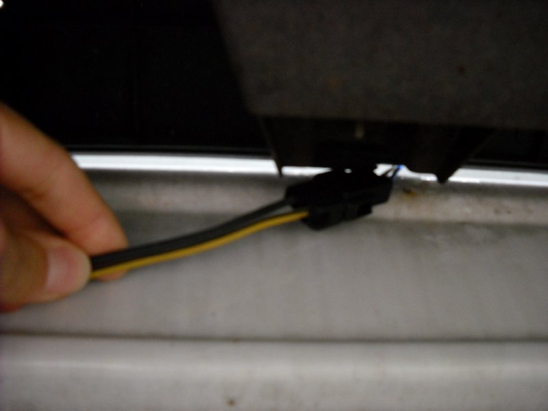

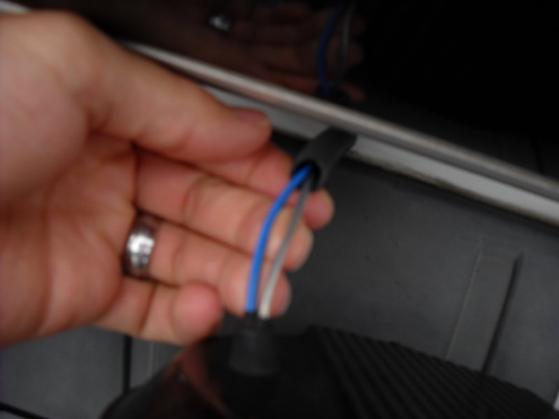

Here are a few pictures to maybe help out...

The fog light wiring and switch are not original. Your power source could be from anywhere. Start @ the switch to see if you have power on either side. If you don't start tracing the wire that doesn't go to the lights for your power source and maybe blown fuse. The bulbs can be checked with a meter or run temporary wires right to the fog light.
