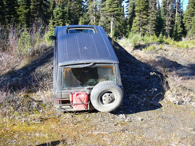

I like that picture of the Delica crossing that river, I like the tail pipe being bent up like that. Makes me think he has crossed a lot of water in his day!
Josh
Green1
Posts: 3257
Re: Spare Tire Swing Out?
Post by Green1 »
I doubt that's the tailpipe... I think it's a rear bull-bar of sorts...

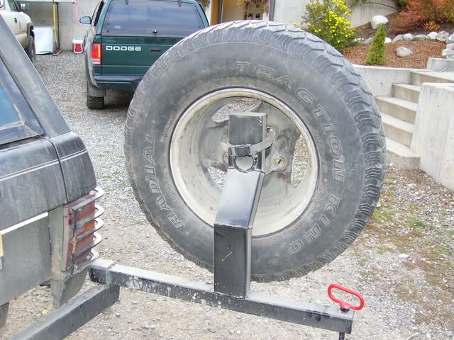

I am planning to build a new bumper with a swing out tire carrier and rack similar to this one I built for my old Range Rover:
To make the bumper take the weight I'll have to build frame rails around the unibody rails and bolt through to a plate in the floor. I don't think the unibody is strong enough.

docsavage wrote:I am planning to build a new bumper with a swing out tire carrier and rack similar to this one I built for my old Range Rover. To make the bumper take the weight I'll have to build frame rails around the unibody rails and bolt through to a plate in the floor. I don't think the unibody is strong enough.
Now that is a sweet solution. Too bad it couldn't be tagged on to my original chrome bumper, but you are probably right, not enough strength there.
