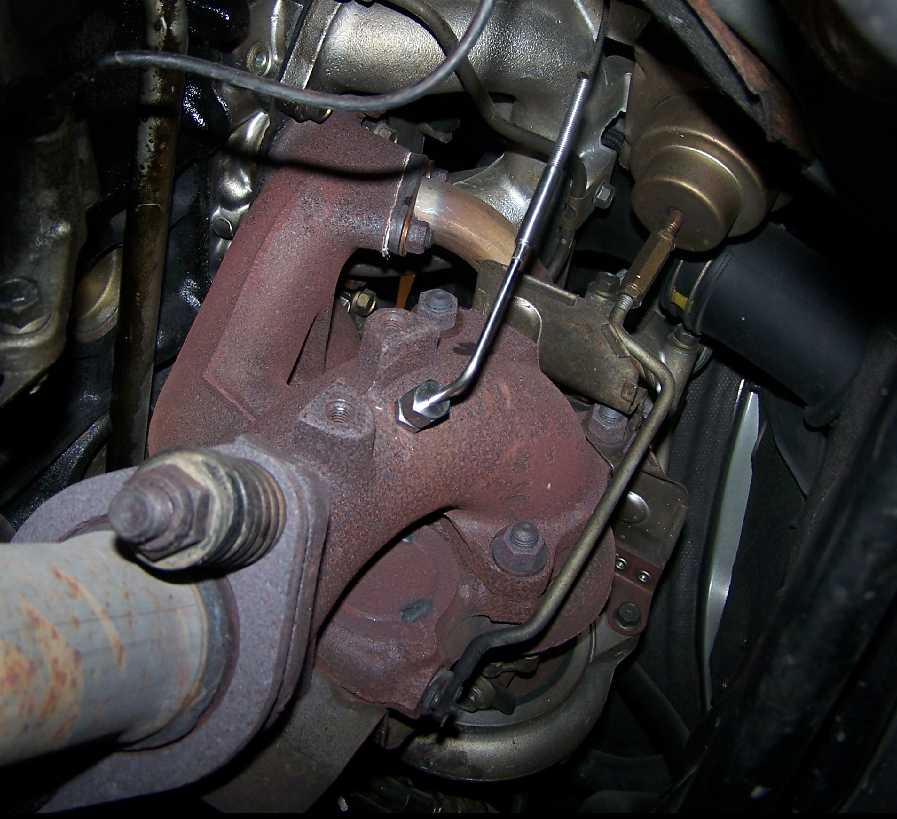

Re: Pyrometer Probe Installation Question
This is the location I installed my probe. It was an easy place to drill and had lots of thickness to tap. Your Probe should have instructions on the size of drill and tap required. You can buy the tap for a few bucks@ CT or any tool store.
- 2- Pyro Install.jpg (66.75 KiB) Viewed 8833 times
-yeah i drilled the manifold pretty close to where yours is located, but the i got a little sloppy in the end with the drill and now im having trouble threading in the bung. im sure i will get it to fit!
