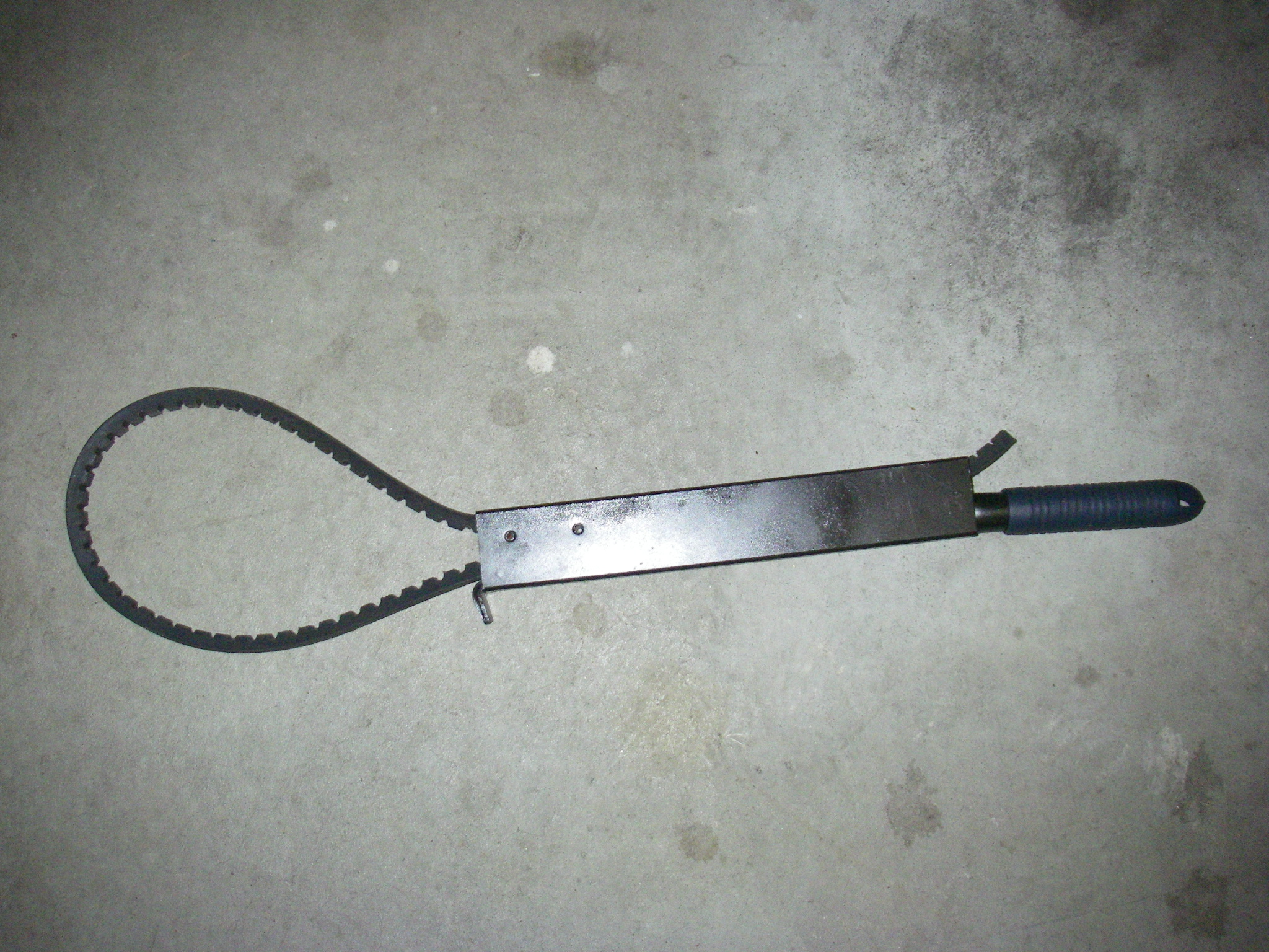

Hi all, i have finally been able to start working on the Delica (work has been hectic), so i managed to take the fan/fan clutch/water pump pulley off but now i have got to the stage where i have to take the crankshaft pulley off, but i dont know how to stop it from turning. Even if i try and hold one of the timing belt pulleys while trying to turn the crankshaft pulley bolt, i still get a bit of movement on the crankshaft bolt. Where do i go from here?

Visit your local automotive parts supplier. They should have a pulley wrench. It's a piece of square tubing with a fan belt on the end that wraps around the pulley and attaches to the wrench. The wrench backs up and holds the pulley in place while you remove or tighten the crank bolt. Not an expensive part either but also usful to remove/tighten oil filters on the delica.
