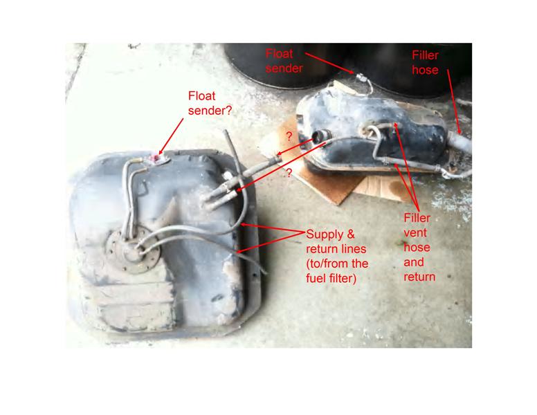

I have both tanks out of an auto L300 and will be using the smaller one as a diesel tank on my L400 for starting/purging.
I'm going to take the guts out of the larger tank and try to use them in a 75L fuel tank for veg.
Does anyone have a link or details on which tank does what/wiring diagram/fuel line diagram ?

From what I can recall both tanks have a level float in them; the forward one is connected to the filler hose; and the tanks are connected with supply and vent tubes between them (i.e. the IP draws fuel out of both tanks by drawing on the forward tank). It's a complicated system that really should have been replaced with a single tank. Not sure why the two tanks, neither of which is 55 litre tank of the base model.

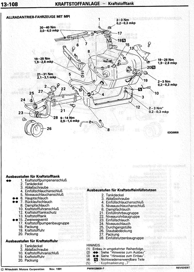

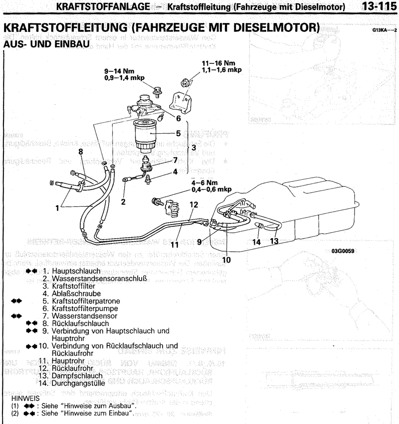

Jesse, this might help a little bit. Good luck with the translation 8-)
Re: L300 dual tank system q
Vielen Dank Felix. Endlich mal jemand reagiert!

i cant see where there is any indication that those two tanks are plumbed together...

IMHO: what is shown in the two manual pages above are actually individual tanks (i.e. they are two separate tanks that are not part of a dual-tank setup). That being said, what you've got pictured in the OP are obviously from a two-tank system. Give me a bit to look at the drawings and the images and I'll see if I can figure it out.
Without seeing how it was fitted into vehicle, this is what I've come up with:
Two tanks.jpg (49.91 KiB) Viewed 5803 times
