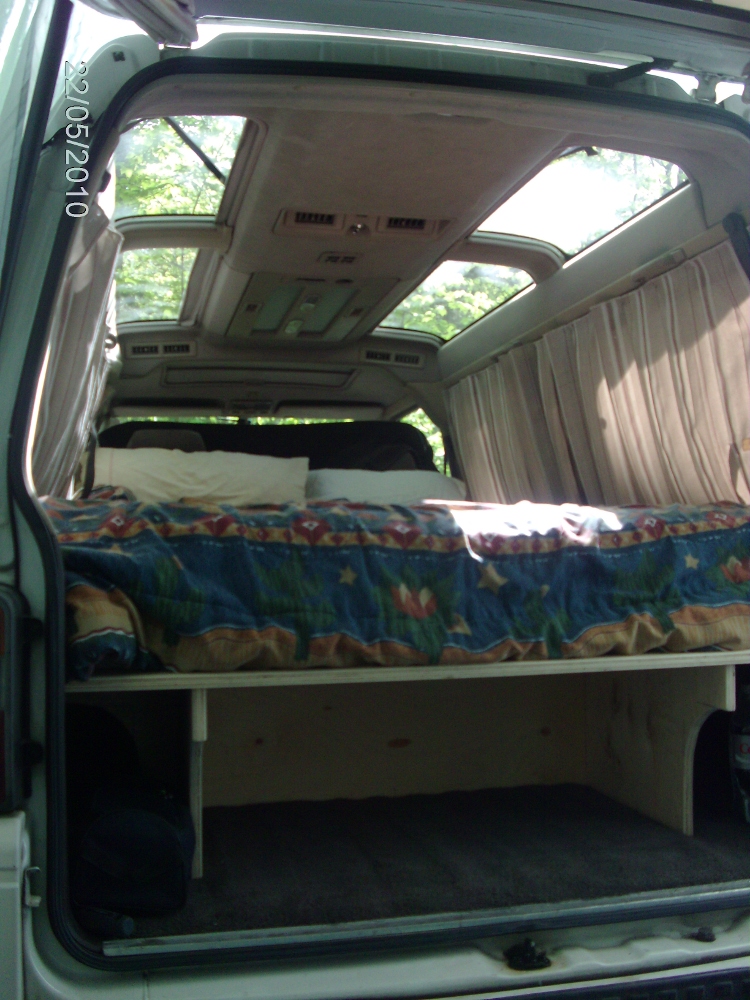

The Bed: I wanted to keep the design simple and be able to keep the two front captains chairs. Using two pieces of 3/4 ply I made a bed with a hinge. When in use the front piece unfolded and sat just above the chair seats which were turned around to face the back. The front was supported by a leg of plywood made to be self supporting and removable. When not in use the leg is removed, the front folded back onto the back and the chairs spun back into place. The back part of the bed is supported by taking plywood and making a self supporting stand that can easily be taken apart. No pictures of the assembly yet just the finished product. Oh and for our mattress we put in a spare double mattress we had in storage. Nice cushy sleep.
