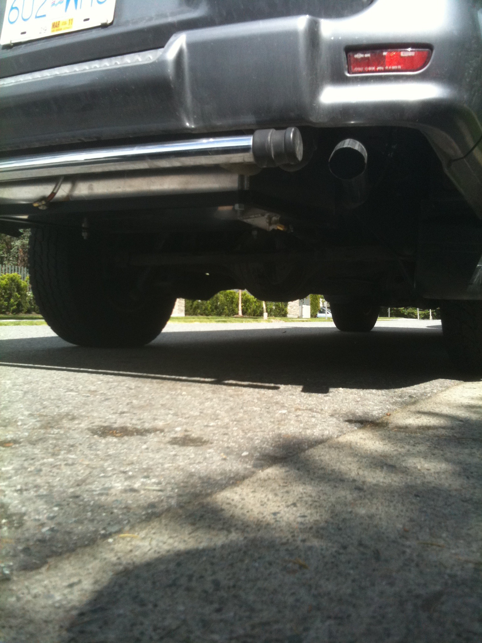

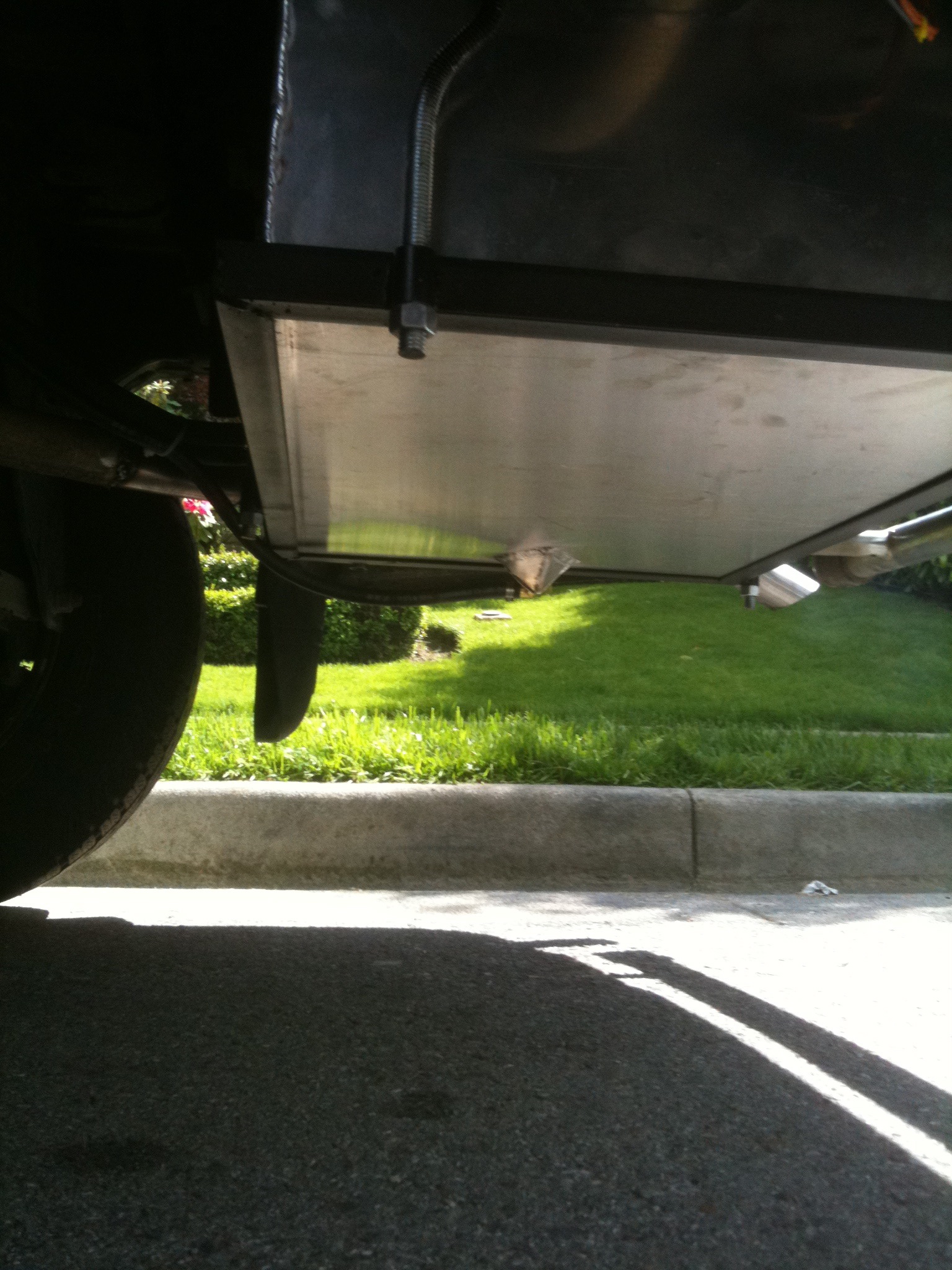

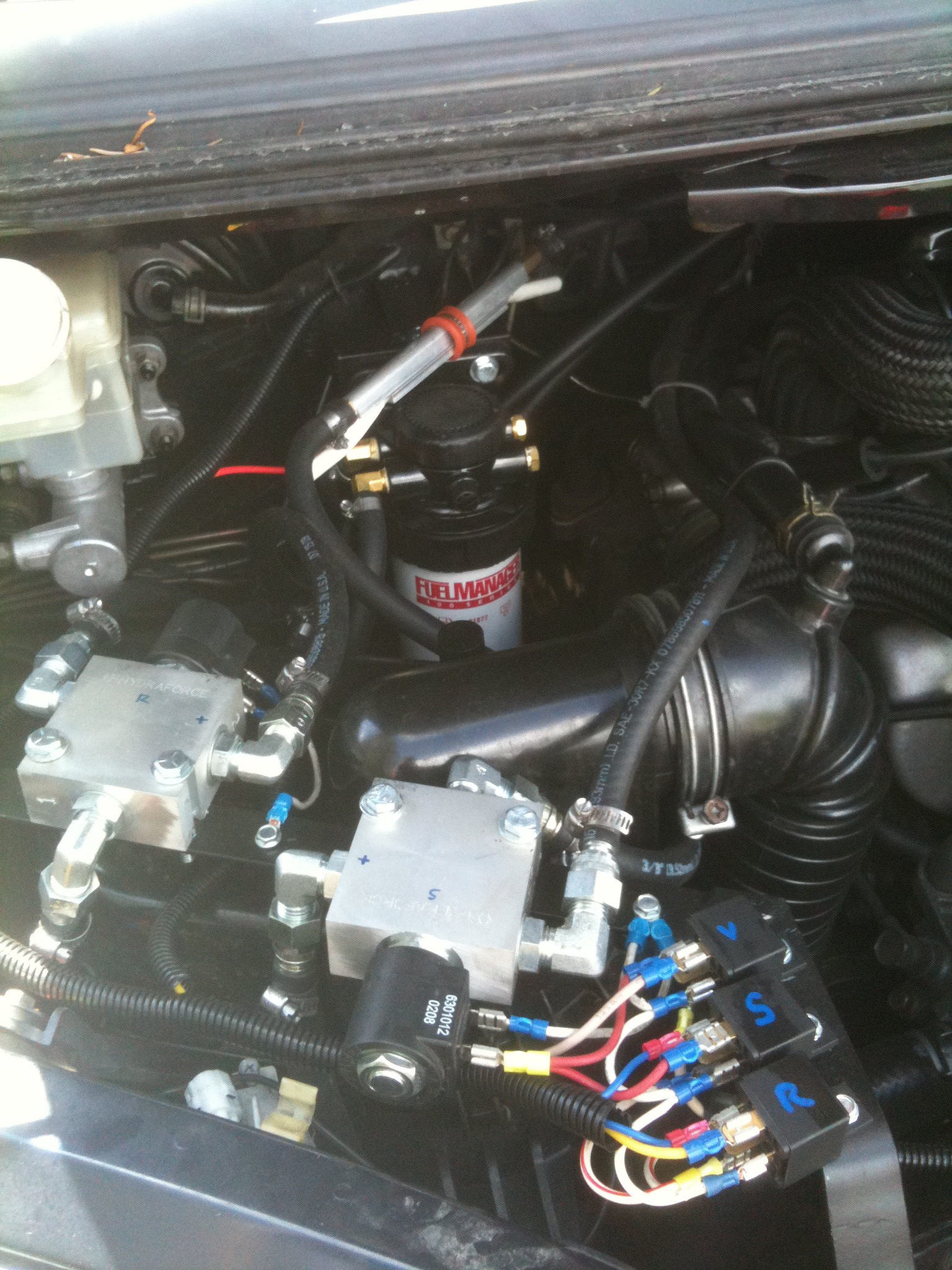

Just finished an L400 conversion the other week and thought that you guys might want to take a look.
78L heated tank and most of the other parts that the L300 kits include plus a little exhaust work.
Andrew

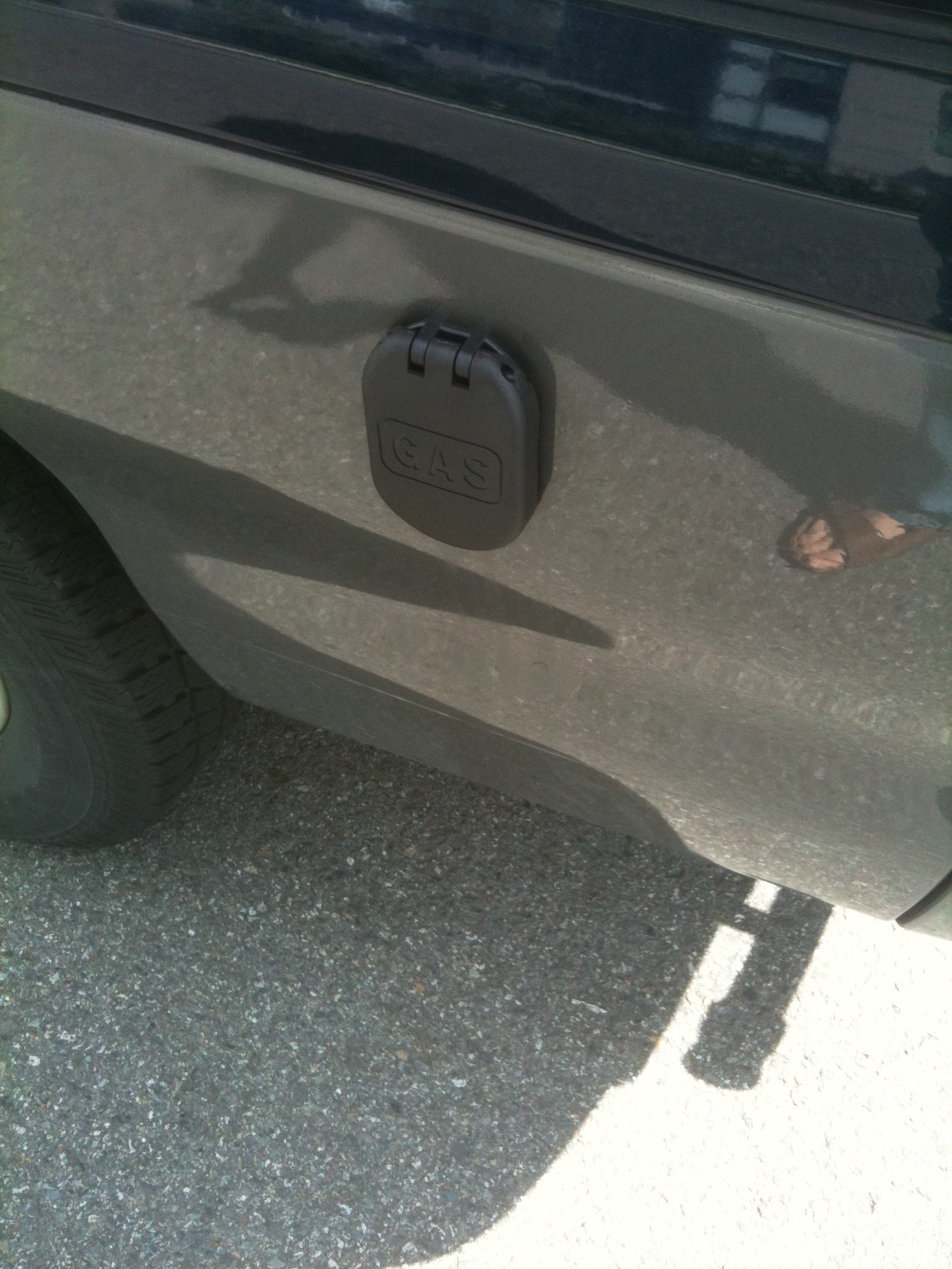

I've never seen this kind of filler cap, interesting! Was the filling tube and vent easy to route?
Who's the lucky owner? If she/he's local I'd be happy to give some filtered oil as a welcome!
David
Re: L400 WVO conversion done...
You'll see it up in whistler.
One of the local eatery owners. :M

I'm starting to plan mine more seriously now and am collecting parts. Where did you get that "GAS" fill door? I would like to do much the same. I'm curious, do these motors need a lift pump?
Rudy
Jordan
Posts: 198
Joined: Fri Dec 04, 2009 8:47 pm
Vehicle: 89 low roof L300
Location: Nelson, BC
Post by Jordan »
The "Gas" door is a vented marine tank fill.
http://www.perko.com/catalog/category/f ... oduct/137/
