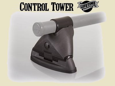

Hey there, I 'd love to see some pictures or ideas of what people have done for roof racks on the SWB. Unfortunately there arn't rear windows, and short of cutting into the seal, the standard bolt on removable towers dont fit.
Has anybody had any experience with Yakima Control Towers? I've been quoted around 500 for a set at Rack Attack. Do I have any better options?
The base mounts directly onto the hood, and the towers just click in and lock. There is a rubber cap to protect the base when the towers are off. They are fastened by a self tapping fastner that goes through the sheet, then drops a butterfly fastener to permanently mount it. Sounds easy, but how strong is this method?
Can I abuse this with a small aluminum boat/canoe plus some gear underneath? Im only worried about the top buckling in spots or cracking paint and such.

I would speculate this would be the kind of roof rack where you read the load rating is 50 pounds. I too miss rain gutters on my SWB...

Yeah, I think its something like 50lbs/rail.
Are those loose estimates trying to cater to the guys that will try to double that?
I just want to be able to fit my canoe on top, and a large gear bag/duffel bag under it between the rails. Possibly a light basket to help with the job if it doesn't add too much more stress. I also don't want to worry about it the hardware shearing and my load spilling while wheeling and Im not sure if I should trust that system.

I think the conservative load estimate is due to the thinness of the sheet metal the screws are punching through. I would rather try to find the rails that look like they mount into the rain runners. The problem with having a GenII SWB is it wasn't sold in the States as a Montero, so we can't tap into that after-market. :cry:
