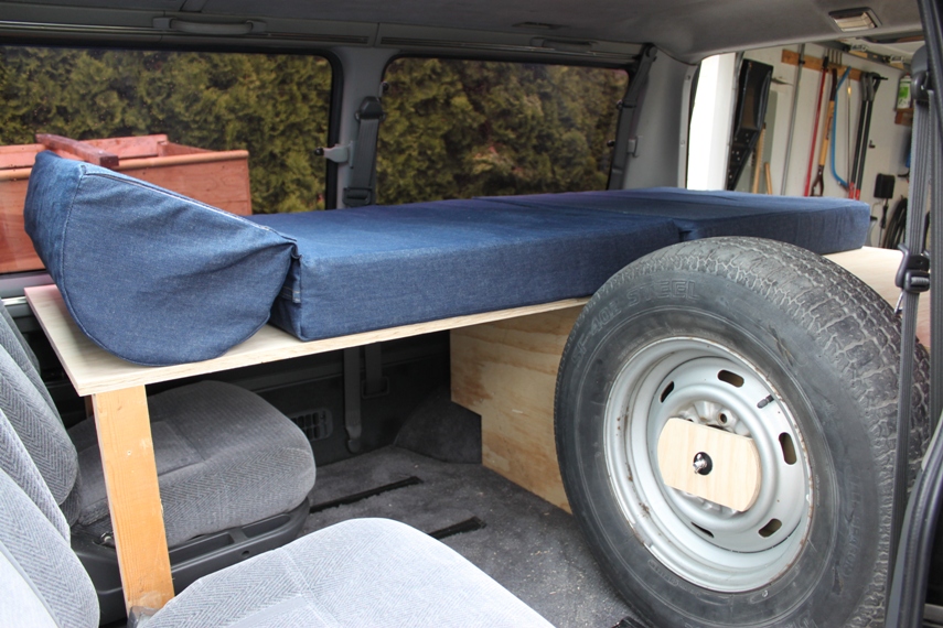

Well, I finally decided what I wanted to do as far as my sleeping arrangements in the Deli... I based the whole design around the need to fit my dogs crate in the van while camping...
Did a mock load... I was surprised how much I fit in there...
Up top there is 2 coolers, 3 plastic totes, a BBQ, a tent and an air mattress... still had some room to spare.
The bed is quite comfy and snug... reminds me of sleeping on my parents boat as a kid.
Sleep side.jpg (282.9 KiB) Viewed 5685 times
You can see that I mounted he spare in front of the storage... works well...

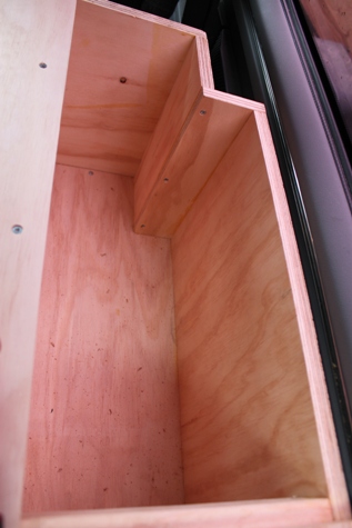

To get some storage I built lockers over the wheel wells... a nice amount of storage...
Locker 2.jpg (75.18 KiB) Viewed 5686 times
Locker right.jpg (77.26 KiB) Viewed 5682 times
I am pleased with the outcome and look forward to some camping... can't wait...

You have been a busy fellow since I've been gone! Looks like an excellent job!... wouldn't expect any less. You've even got the weather checker skylight to see if it's worth getting out of your comfy spot. Been thinking about getting into this type of project too.

You've quite handily overcome the one problem most try to deal with by simply raising the bed platform higher. Most are trying to figure out how to get good stowage when the platform is only as high (or little higher) than the wheel humps. But by fixing it as high as you have, it looks like you've got gads of stowage. Good job!
I see a trailer to the right in one shot, but no hitch on the back of your van - is that the next mod?

Why isn't your spare tire under the Deli?
Richard Dagenais
Re: Getting ready to camp
RichD wrote:Why isn't your spare tire under the Deli?
Because it's bloody hard to get at should you ever need it. But that's just why I took it out from under there when I had a van.

Hey Paul... my dogs kennel was the basis for my design as I want him to sleep in the van while camping but not in my bed or anywhere that I have to listen to him licking himself... :shock: I would say that this is about as high as you would want to build a platform in a lowroof as I don't have that much room in there. It reminds me of sleeping under the cockpit of my parents boat as a kid... although that was tighter. I really do have an awful lot of storage area and th lockers are great for all my smaller gear that I carry all the time. As for my next mod... curtains... I need some privacy in there... Trailer hitch would be nice... I need to get my fabricator friend to work for me although more for a bike carrier than for towing.

Rich... I too love plywood... nice to work with. As for the spare, as Paul states it is a bit of a bitch to get out from underneath... especially offroad... but the other issue I have is that I keep smacking it into the dirt and rocks when I go offroad... I do not like that sound or the possibility off wrecking it...
