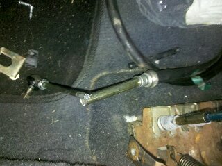

we are just camping outside the garage we took our van to :) the reason for our missing reverse was a broken cable in the shifting mechanics, hope that describes it... We got to wait until tomorrows delivery to get it fixed. No big deal really.

the cable just broke flush at the fitting
